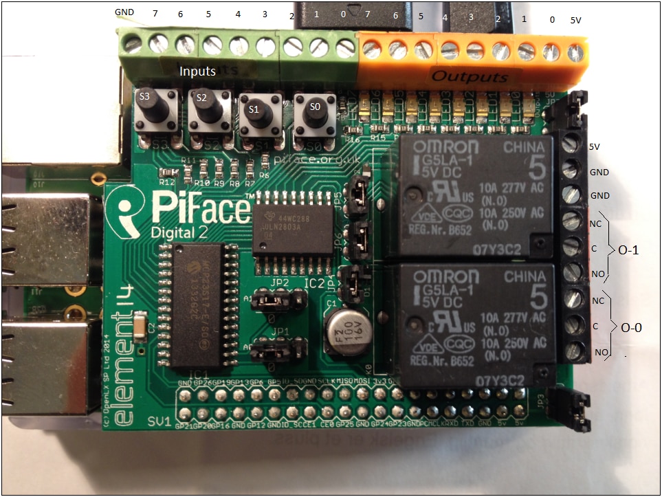

Tour of the PiFace Digital 2
Picture Description:
IO connection terminals: Starting from the bottom right corner of the picture above and working counter clockwise along the PCB edge
  • (O-0) first up are the 3 connection terminals for the first relay which is controlled by output 0. The first terminal is connected to the Normally Open (NO) terminal of the relay, the second is connected to the Common (C) terminal, and the third to the Normally Closed (NC) terminal.
  • (O-1) next are the 3 connection terminals for the second relay which are controlled by output 1. The first terminal is connected to the Normally Open (NO) terminal of the relay, the second is connected to the Common (C) terminal, and the third to the Normally Closed (NC) terminal.
  • Next are two ground connections, followed by a 5V connection.
  • Then on the top edge of the card starting from the right is a 5V connection followed by the 8 terminals that are connected to the open collector outputs (the orange connection blocks). These are controlled by output 0 through 7 in that order. The corresponding surface mounted LEDs can be seen just below. Note that output 0 controls the first relay, LED 0, and the open collector 0.
  • Next up to the left of the outputs along the top edge are the input terminal connections (the green blocks), beginning with input 0 through to input 7, then lastly a connection for ground. Below these are the 4 push button switches. Input 0 through 3 are controlled by the status of the switches as well as the signal levels of the input teminals. For example, either S0 must be activated or the signal level at input terminal 0 must be high or both must be active for input 0 to be interpreted as '1'.
I have tested every input and output on my PiFace Digital 2 - both with the emulator and with my own Python3 script (actually the only input i tested with my script was the push button input signals) - and everything worked as expected.

    Hi Raymond,
    many thanks for your detailed giude!
    I am a linux newbie and I'm struggling to setup piface digital2 on my brand new RaspberryPi B+. Actually all steps from your procedure completed without errors but virtual device GPIO is missing and as a result pifacedigital-emulator gives an exception on startup.
    I did look for /dev/spidev0.0 and /dev/spidev0.1 and they are present (so I guess kernel module is ok).
    I did also look for /sys/class/gpio which is present, and tested doing echo 25 > /sys/class/gpio/export, it actually create /sys/class/gpio/gpio25 so permissions are ok.
    Any idea on what to check next would be very appreciated!
    Thanks,
    Daniele

    urkraft over 11 years ago in reply to e14 Contributor
    Hello Daniele,
    Firstly, i would like to point out that official documentation for the PiFace Digital 2 is now available, and that it should be used instead of the document that i published when it was still undocumented.
    And now i address your problem:
    I am almost certain that your problems are due to you running this command that was included in my document:
    sudo rpi update
    I apologize deeply for including it in my documentation. I have found out a short while ago that that command is only meant to be used for advanced Raspberry Pi users to test an experimental version of the kernel. Unfortunately some major changes are introduced in the latest experimental version which i am quite sure are responsible for the problems you are experiencing. You need to roll back to the last official version by issuing the following 2 commands (and NEVER use the above command unless in a normal Raspberry Pi working environment):
    sudo apt-get --reinstall install libraspberrypi-bin libraspberrypi-dev libraspberrypi-doc libraspberrypi0 raspberrypi-bootloader
    sudo reboot
    After the Raspberry Pi has rebooted and you log in the problem should no longer be there.
    Again, i apologize for including the command that has caused you these problems. When i created the document that i had published i included it because i found a reference somewhere on the internet suggesting that it always be used when updating the Raspberry Pi. That source did not mention anything about it's real purpose.

    e14 Contributor over 11 years ago in reply to urkraft
    Hi Raymond,
    thank you for the explaination.
    I made a little bit more of research and I found out about overlays... Not that I master this concept but the basic effect is that I have to explictly enable additional devices to be inserted in device tree by adding a line in config.txt
    So I gave it a shot and added to my config.txt the following two lines:
    dtparam=spi=on
    dtoverlay=bcm2708-rpi-b-plus.dtb
    After rebooting everything is working perfectly. Now, if this change introduced in firmware is a 'preview' of what is coming in the future, I think that keeping my current firmware (and config) is ok even in case of future upgrades, correct?
    In any case thank you very much for your help!
