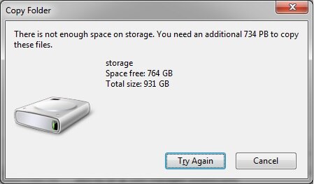

    Great stuff Grant, one problem!
    I need another 734PB of disk space to extract.. tried downloading twice, must be corrupt, same result.
    Will try later this evening.

  • soundcamp
    soundcamp over 11 years ago in reply to binauralhead
    Hi Alan
    Thanks for picking that up.
    I'll check it out and see what's going on
    bw
    grant
  • soundcamp
    soundcamp over 11 years ago in reply to soundcamp
    Hi Alan and all
    We have uploaded a verified new disk image to  the soundCamp resources page
    soundCamp resources - Pi SD Card - Download
    I hope that will work fine now
    Let me know if you have any other issues
    bw
    grant
