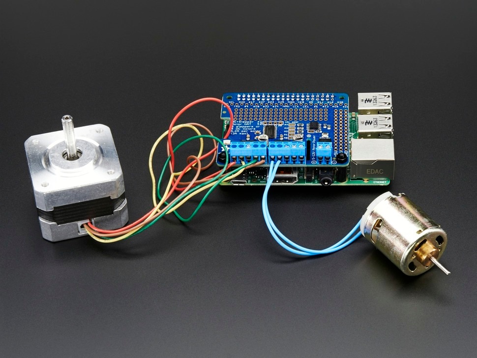

    https://www.adafruit.com/products/2348
    And, if you really want to go wild, there are CNC machine controllers driven by an Arduino and controlled by a Raspberry Pi.
