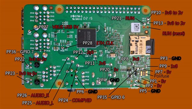

    I see your point and agree. Also I do believe there is some information, albeit unofficial, on PP27. From here it seems to be that PP27 is the VBUS (USB 5v Power) in which case should the voltage not be between 4.75v and 5.25v as the RPi's voltage range is  5.0V±5%?

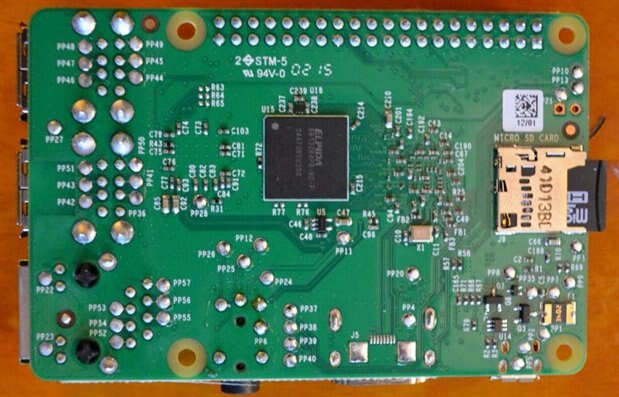

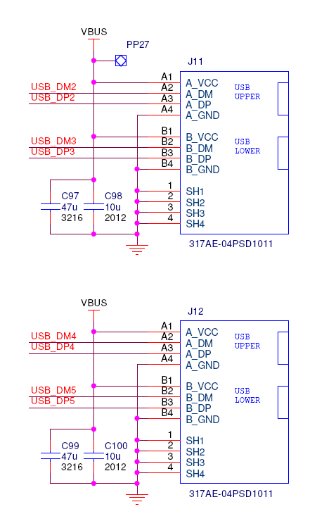

    e14 Contributor over 10 years ago in reply to RParkerE
    Parker, i have it too, but too many information misssing. What about points 41 trhu 57 , my problems is on usb ports . image
  • RParkerE
    RParkerE over 10 years ago in reply to e14 Contributor
    As Shabaz and Gary have said, with only a partial schematic, these points have not been disclosed. I have not been able to find any suggestions on any other forums either, unfortunately. Can you explain more clearly what the problem  you are experiencing is? Maybe we can find more useful information from there that can lead to a solution rather than use the test points?
    Parker, i don´t think is this the right place for the problem , but..
    My problem is similar as this https://www.raspberrypi.org/forums/viewtopic.php?f=28&t=110164&p=760997
    Make the sugestions with no result.
    If anyone has any other information to complement, I'll updating the image.

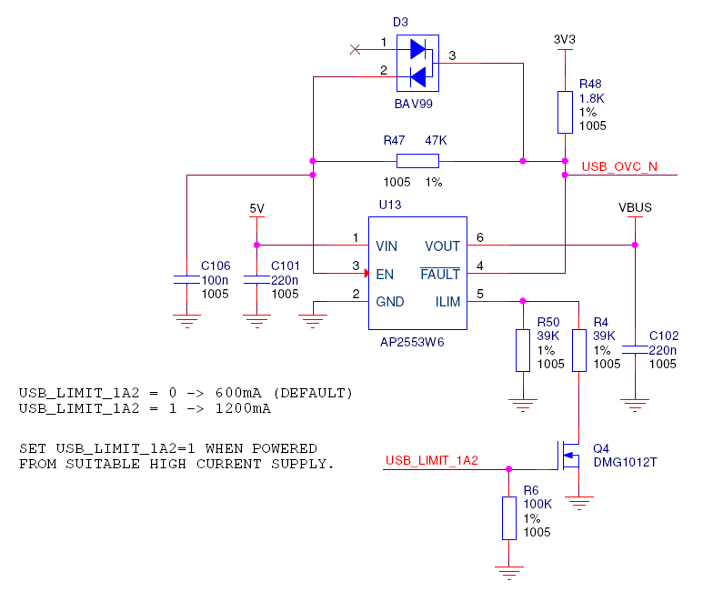

    mcb1 over 10 years ago in reply to mcb1
    Not sure if these will help
    The USB_LIMIT_1A2 is driven from the LAN9514 chip Pin 35.
    e14 Contributor over 10 years ago in reply to mcb1
    Hi, mcb1
    Many tx for your information, i´m try fix a rasp 2b.v1.1.
    It´s exactly what  I need.
    Thank You.
