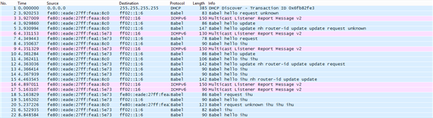

Hi, I'm facing a problem running babel on my raspberry pi model B
here are the steps which I made:
  1. 1. installation
# sudo apt-get install babeld
  1. 2. running bable deamon on wlan0
# sudo babeld wlan0
An error message appeared –> Couldn’t read forwarding knob.: No such file or directory
kernel_setup failed
I am new in linux and im trying to build up a mesh network with 4 Raspberry Pi's. Here are the Hardware details:
4 Raspberry Pi Model B running rasobian wheezy (Linux 3.18.11+ #781)
4 WiFi USB dongles TP-LINK TL-WN722N (AR9271)

    This happens when babeld cannot read /proc/sys/net/ipv6/conf/all/forwarding, which specifies whether forwarding is allowed for ipv6 interfaces. In my case, this happened because the ipv6 kernel module was not loaded, so /proc/sys/net/ipv6 did not even exist. Try “modprobe ipv6″; that should fix it.
    But user found that:
    I’m sorry to waste your time i checked the source code and found the error has to do with IPv6 not enabled. I added IPv6 to “/etc/modules” and it went through fine.

    Hello clem57 , Thank you for taking time to debug the code. I tried what you said and added ipv6 in /etc/modules to run at boot time. after running babeld wlan0 the pi does nothing till I cancel the process with Ctrl+C . I'v tried to run babeld wlan0 on 2 Pi's and ssh both from a laptop  and noticed that the pi are sending some kind of hello messages.
    is that the way babel should be working ? many thanks

    Yes this is a request to update information tables. But seems not to be understand on the other side. Check the demon is runing al machines
