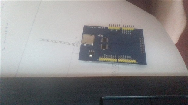

Will a  UNO R3 2.8" TFT touch screen with SC card socket work with the Raspberry Pi 2 B?
  • clem57
    0 clem57 over 11 years ago
    The answer is maybe. Can you post a picture of the pins? Is it "SPI" interface? I found this https://learn.adafruit.com/adafruit-pitft-28-inch-resistive-touchscreen-display-raspberry-pi showing software to use if you can get the pins to match. But I will say you will need to work to connect the interface with the Pi pins physically at least.

    0 e14 Contributor over 11 years ago in reply to clem57

    If it works with the UNO then it can work with the RPI for sure. Providing the details as stated above will permit a better answer though

    A link to where you bought it would help. Or to a manual and any other details . A schematic would be awsome

    As it is a specific device you already have there, please can you post the datasheet or the link of the exact product ?

    Hi Shay,
    I also received this notification from Amazon in Spain. I checked the users review before buying and I found this that made me suspiciuous:
    These are FAKE. They are unsuitable for an Arduino as they have a 16-bit interface while the Arduino only has an 8-bit, therefore they cannot be made to work. The screens have been mounted on an 8-bit board which connects directly to the top of the Arduino Uno, so at first glance it appears they should work, don't be deceived!
    This is an example of very poor and unethical construction. Taking an item and mounting it to a PCB that you know will prevent it from working and then marketing it as something which it is not.
    This comes with no documentation, and after extensive research and experimentation, blood, sweat and tears etc you discover that you've been ripped off as it inherently CAN'T work no matter what you try. Sure you can get some limited functionality, colours displaying incorrectly, draw basic shapes etc, but you can't display characters or graphics as you should and therefore it is useless as a component for a project.
    The trouble with sending 8-bit code to a 16-bit device is that you can only address the first 8-bits of the screen, so anything that requires bits 9-16 to be addressed remains forever unuseable.
    The only hope if that in some way, despite the 16 bit addresses there is also an alternative way to make it working in an 8 bit environment. If you enlarge the only one image of the device back side, you see the following (with some small image enhancement):
    Only can confirm to us for sure but these PINs seems LCD RST, CS, SS, WR, RD so maybe there is a way to drive the LCD in a different way than 16 bit pin addresses. One try to be checked - if the speed is sufficient - is with a couple of shift registers daisy-chained, but I am not sure if the frequency response of the shift registers is sufficient. If it is, it is one of the solutions using very few pins on both the Arduino and Raspberry PI. About the shift registers you can take a look to the following link: https://www.tindie.com/products/alicemirror/daisy-chained-shift-registers-board-arduino-kit/
