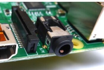

    As Clem points out there might be a cable problem, but the link to the cable you have above shows the correct configuration.  I'm wondering if you don't have a problem with the ground on the socket.  The gold ground inside the socket is a tension bar.  It can get flattened or pushed back so the connection isn't good electrically.  Check the placement against the socket in the picture for reference.  For electrical sockets with this type of ground I usually use the end of the barrel of a ball point pen to gently pull the bar up.  You don't want to push it back or deform it, and this way usually prevents that.
    0 e14 Contributor over 10 years ago in reply to e14 Contributor
    Thanks Brian Edwards, will try this today and let you know what happened.
    No luck still it's not working image
