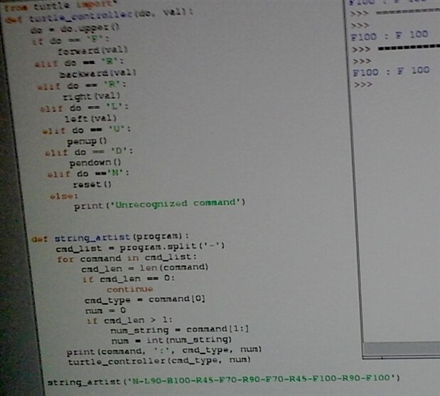

Hi guys,
Can anyone tell me why the code in the left window (in the attached photo) is only making the Turtle draw just one straight line, when it is supposed to be drawing a house? I've checked and triple checked and I can't work out the problem.
Any help anyone can give me would be greatly appreciated.
Kind regards,
Richard.

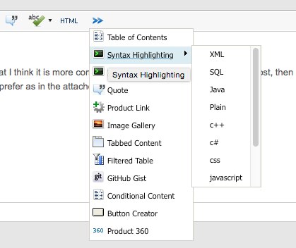

    Hello Richard,
    please instead of attach a jpg of the screen top-down and out-of-focus (that I think it is more complex), copy the code and paste it in the post, then select the code and from the last right button menu (the one with >> sign) select from the dropdown list the syntax highlight mode you prefer as in the attached image below.
    BTW: when you need to add an image, instead of attaching the file (better when are zip files, pdf and not images) you should click on the camera button on the editor menu and select the image from your computer (or the web or elsewhere) and insert the image inside the text. All will be more understandable.

    Here's the picture, sharpened a bit:
  • ntewinkel
    0 ntewinkel over 10 years ago
    I see that you have 'R' in there twice - so it interprets it as backward and you'll never have a right turn.
  • ntewinkel
    Also, Python is VERY picky about indentation. You need to indent the two lines above the final string_artist(...) line so that they are part of the "for" loop. I'm trying this out right now, and it looks like the long string is also missing a line drawing command (the turtle only draws on forward?)
  • ntewinkel
    0 ntewinkel over 10 years ago in reply to ntewinkel
    ok I see a house now. indent print and turtle_controller lines, and you have a typo in the command string: R100 should be F100.

    Here is the code, fixed up:
