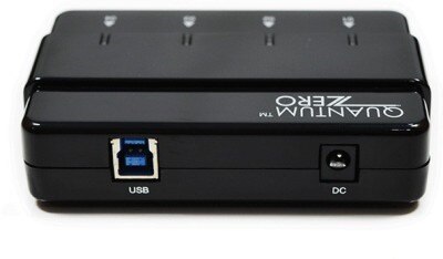

    0 e14 Contributor over 10 years ago
    this is the usb hub i have i connect my rpi with that weird looking usb port you can see at the back. Hub is quantumzero qz-hb05 , its 1x4 usb 3.0image

    0 clem57 over 10 years ago in reply to e14 Contributor
    Very nice build quality. image The only issue that I found is, without using the power cable plugged in, the hub does not work.
    • VIA VL812 Rev B2 chipset with latest firmware for best performance and widest compatibility.
    • QuantumZERO USB 3.0 4-Port 12V 2.5A Powered Hub, 12V 2.5A Power Adapter, USB 3.0 Data Cable
    Because this is a USB 3.0, it may not be fully usb 2.0 backward compatible for Arduino. Please try directly on the USB plug into RPi 2. That should work.

    AS wrote>>...this is the usb hub i have i connect my rpi with that weird looking usb port you can see at the back...
    ELY Reply>> This is a Female USB3.0 full-size B connector. Remember RaspPi's USB-A -goes-to-Hub's-B. I assume you have such a Cable. Whether it is USB3.0 OR USB2.0 Cable. I also assume that this USB3.0 Hub IS BACKWARD w/ USB2.0. WRT to USB plug/jack/cables: Do a "Wiki' on USB. There are Two Tables (of particular Interest) and that is the mating of Female Receptacles (Jacks?) and their Corresponding Male Receptacles (Plugs?). Although your USB3.0 Hub may SAY it is backwards compatible, maybe you should use ALL USB3.0 Cabling, EVEN though your devices (RaspPi , Arduino Uno R3) are USB2.0

    0 e14 Contributor over 10 years ago in reply to clem57
    Yes connecting directly to rpi works but the main problem why i bought the externally powered hub was because of current drops in rpi when arduino is connected
    for eg.
    >if i have a arduino with a load(like a servo) connected to raspberry pi's usb there are current drops in rpi and rpi freezes
    >but if i have a small load connected to arduino(like a LED) everything worked fine
    Hence i thought this could be a Amp problem so.. i bought a externally powered hub.
