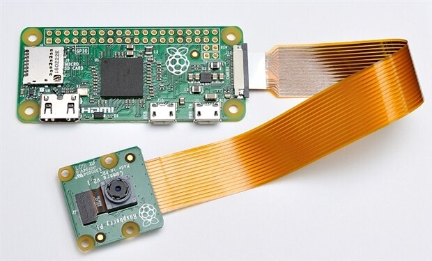

Is it possible to attach the Pi Camera to the Pi Zero

    The original version of the RPi Zero didn't have that connector, but the new version does.

    From Adafruit:
    https://www.adafruit.com/products/2885
    Note: As of May 16th, 3 A.M. EDT Adafruit is now selling version 1.3 of the Pi Zero.  Version 1.3 is updated to include a camera port.  The new Pi Zero camera port only works with a Raspberry Pi Zero Camera Cable.  It DOES NOT work with a standard Raspberry Pi Camera cable.
