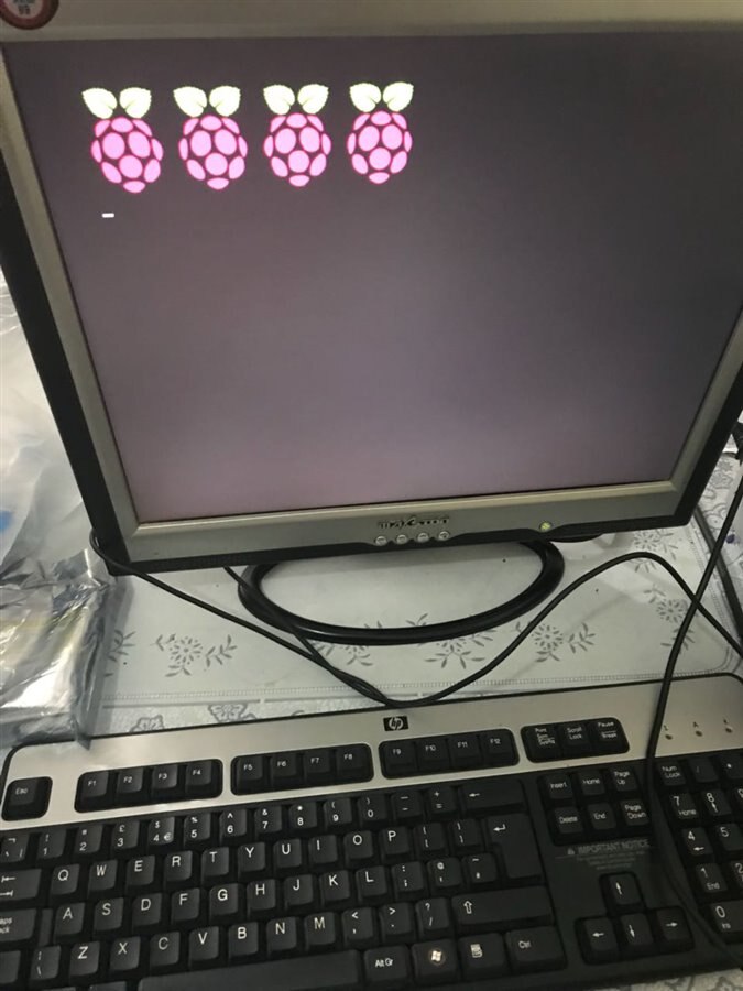

    My raspberry pi is stuck here what should i Do?image

  • e14phil
    0 e14phil over 8 years ago in reply to bushra
    Hey Bushra
    As with most of these, it looks like the SD card could do with reflashing.
    Give that a go, or try a different SD card.
    Phil
