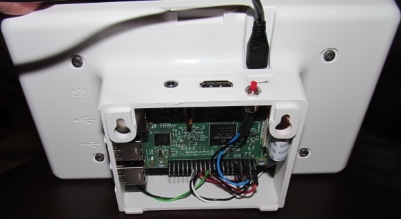

    0 paulnewton over 8 years ago in reply to jgcobra
    Hi Graham,
    I tried the method described in howchoo on my Raspberry Pi 3 with Raspbian.
    This has just a single push button with no other components.
    The button simply shorts ground (e.g. pin 6) to pin 5 gpio.
    If the Pi is in its low power shutdown state after being previously shutdown, taking pin 5 low does wake it up.
    Then after booting, a Python program listens for an interrupt on the same pin, and triggers a shutdown.
    I found it works really well.
    In my case, I am already using the ground pin 6 for my display, so I used ground pin 9.
    The black wire is ground, the blue wire is the GPIO:
    HowChoo also has an article for adding a power LED to signal when it is safe to remove power.
    I fitted the LED next to the power button (its not shown in the picture above).
    I found this useful, but a little misleading as the LED shuts off about 5 seconds before the SD card "ACT" LED stops flashing.
    Regards - Paul
