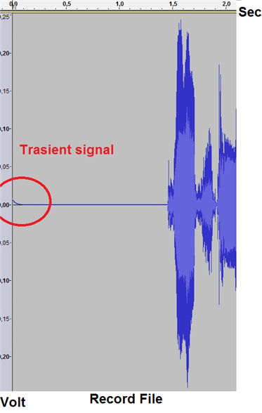

I am having problems when I record an audio file,  because a transient signal appears,  as shown in the following image.
I have two Raspberry Pi2 Model B with two Cirrus Logic Audio Card.  The first Raspberry is used to play a audio file, and the second  is used to record this audio file. In the First it used the Line_Out, and the second the Line_In. I am using the commands "aplay" and "arecord".
My problem is transient signal appearing when I record an audio file.
In the following images is showing the original file and the record file.

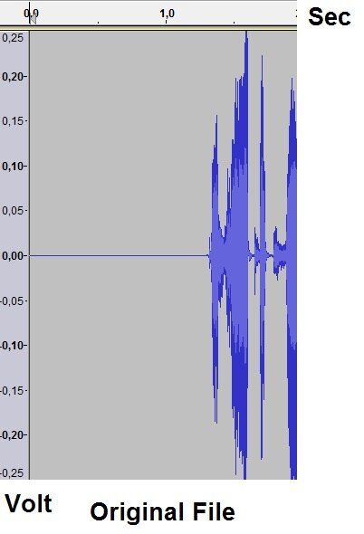

Example1:Original File. Line Out (First Raspberry)
Example1: Record file in second raspberry

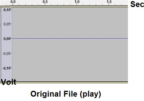

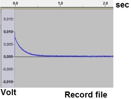

Example 2. Original File.Line Out (First Raspberry)
Example 2. Record file in second raspberry.

    I'm not sure why it's a problem so this may not help too much:
    1) you could try cutting the first half a second off the record file.
    2) Many audio ADCs have a large DC offset and use  a digital high pass filter to remove it - it looks as if the RPi setup you have is only starting the ADC when you start the recording. If you start  a recording very soon after stopping  a previous recording do you still get the problem ?
    The proper solution (if my guess about the error is correct) is to start up the ADC and let it settle before actually recording data - but this would require close control of the ADC which you may not have (without changing the driver code). You might be able to turn the high pass filter off - this will give you a DC offset which you could remove with software.

    My system wants to analyze the transmission channel,for this,  it is compared  an original file with the recorded file. At the same instant, playback and recording begins. The recorded file cannot be manipulated (it not possible try cutting the first half second) .

    0 DAB over 10 years ago
    It looks like you have a capacitance component on your analog to digital converter.
    You can have these types of events if you have a large stray capacitance caused by the input wires.
    Are your audio input lines terminated?
    You night have too much signal driving the device, which allows the off nominal signal to be higher than your signal ground.
    Do some poking around your input device and look at the states before and after you begin to record.

    There is a link to an earlier discussion here which tells you how you might adjust the High Pass filter:
    DC offset on microphones and workaround.
    or you could try to remove the DC offset at the line input.
