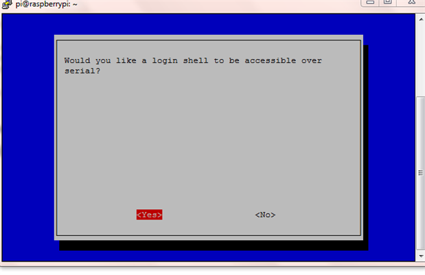

i had try so many code and thing but i dont get the correct answer for how to transmitter or receive the data through GPIO pin of serial port
  • oksbwn
    0 oksbwn over 10 years ago
    gotto terminal ->type
    $sudo raspi-config
    goto advanced options->find serial
    Now over their make default login console through serial Disable
    Now your application can access the serial port.
    It works 100%.

  • rew
    0 rew over 10 years ago in reply to oksbwn
    Bikash panda: Ehh. Modern versions apparently add "enable_serial=0"  to /boot/config.txt so that disables the serialport altogether. You need to check config.txt if that's ends up there, if so, and you want to use the serial port for other things, then you need to change it to =1.
  • oksbwn
    0 oksbwn over 10 years ago in reply to rew
    rew: Ya I am aware of that. But I just mentioned alternate way so that not to mess up with the text file...
  • rew
    No you're not aware of that.... raspi-config will DISABLE the serial port altogether by putting enable-serial=0 in the config file for you. Then you can no longer access the serial port hardware from the ARM side. As far as Linux is concerned the hardware has been unplugged. No "now your application can access it".
  • oksbwn
    This is where you need to make it 'No' . Now any application running on your Raspberry Pi can Access the Serial Port
    And this is  "enable_uart=0" Instead of "enable_serial=0" what u have mentioned. Please check.
    And this works 100% with JAVA and Pi4J
  • prasadjain05
    0 prasadjain05 over 10 years ago in reply to oksbwn
    i had disable the login shell but i dont get idea how to send the data on serial port which is present on board if you can tel me how to send or receive message through UART in Rasberry pi 3
  • oksbwn
    0 oksbwn over 10 years ago in reply to prasadjain05
    After that you can use any programming language to access the serial port depending upon what you are comfortable with.  I have not used python but have used with JAVA with Pi4J Library.
    Just google for Pi4J and that comes with a lot of descent examples.
