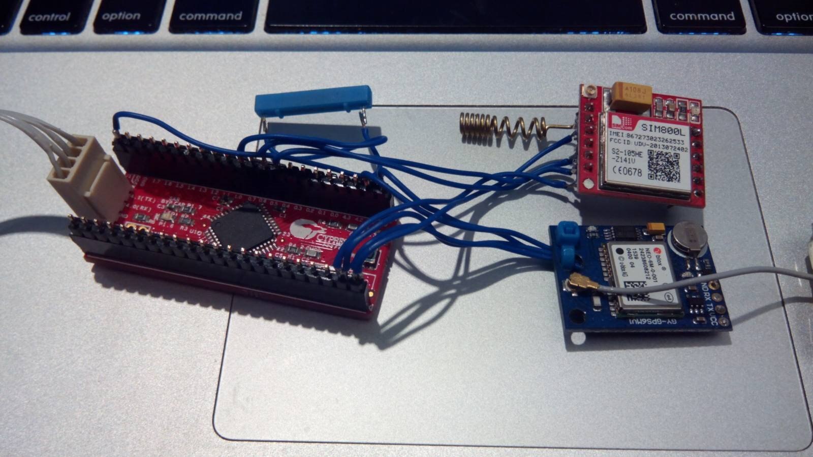

    Instead if you need a more sophisticated project totally under control of your hardware you can buy just a 3G data module that with very few wiring and soldering can be connected directly to the Raspberry PI board via the serial UART and has a wide set of AT comands to control it. The SIM800 module can be found on the market for less than 15$ and I am using it for my project Hugo based on the PSoC4 micro controller.
    https://techship.se/products/simcom-sim800c-gsm-smt/
    For this module exists many breakout boards for prototyping. The image below shows my prototype version of the Hugo project
    Enrico
