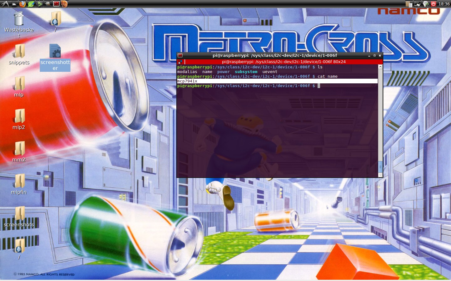

Dear Element 14 Community.
All my Raspberry Pi devices (RPi 2, RPi Zero, and RPi 3 (planned) are running with the current Raspbian Jessie version. I have successfully installed PiFace Real Time Clock using the PiFace website instructions and GitHub.com software download on a number of RPi 2's and one of my three RPi Zero's.
I have recently continued the installations on another two RPi's and cannot continue because after these two lines:
1. chmod +x install-piface-real-time-clock.sh
2. sudo ./install-piface-real-time-clock.sh
The following new comments are returned: 1
1.. create new pifacertc init script to load time from PiFace RTC
2. Adding /etc/init.d/pifacertc .
3. install the pifacertc init script
4. enable I2c by using raspi-config
As I am a Linux beginner, can someone lead me through (expand) the coding of these lines so I may install PiFace RTC currently and in the future. The changelog on GitHub refers to a revision change but I am not knowledgable enough to understand why the install went through previously by not currently.
Thank you very much,
Frank.
    0 e14 Contributor over 9 years ago
    Are those all of the comments that are returned? Having a glance at the install script it seems there should be a piece saying to reboot and another demonstrating how to set the clock etc... If these are missing it would indicate that the install script has not completed correctly.
    Has the install script created the /etc/init.d/pifacertc file? check by typing cat /etc/init.d/pifacertc into a terminal window, there should be around 37 lines of text print out into the terminal as a result.
    If the installer hasnt completed succesfully it should be easy enough to replicate the procedure manually, everything is provided in that script to do that.
    p.s.the comments 1,2 and 3 that appear ate just the install script telling you where it is up to. Comment 4 is an instruction to you to run raspi-config, as I said above, there should also be more text below this

    I appreciate you speedy response to continue with my problem. To re-summarize my total experience with Installing the PiFace Real Time Clock here's additional, more-specific information.
    I had successully installed previous RPi 2's and one of my RPi 0's all running the current Rasbian Jessie software following these websites:
    Starting Website to Add PiFace Real Time Clock
    http://www.piface.org.uk/products/piface_clock/
    Two Links (located towards bottom of site) were followed:
    1. Documentation (downloaded pdf File)
    2. PiFace Real Time Clock on GitHub
    https://github.com/piface/PiFace-Real-Time-Clock
    The previous installation on a RPi Zero (which was successfull) did not generate a /etc/init.d/pifacertc  file
    and during the boot phase, I did see a line:
    [Failed (in red): Failed to start /etc/rc.local compatibility.
    but evidently the clock installed correctly.
    The text for the rc.local files on this device and the RPi Zero device that failed are identical.
    My PATH to install on the failed device is briefly described next:
    pi@raspberrypi ~$ ls
    Downloads  (among other files)
    pi@raspberrypi ~$ cd Downloads
    install-piface-real-time-clock.sh  (in bold yellow/green color)
    chmod +/ install-piface-real-time-clock.sh  (returns prompt)
    sudo ./install-piface-real-time-clock.sh (problems occur)
    returns:
    Create a new pifacertc init script to load time from PiFace RTC
    Install the pifacertc init script
    Enable I2C by adding:
    raspi-config
    then navigate to "Advanced Options" > I2C
    and select 'yes' to enable the ARM I2C interface. Then *reboot* ans set the clock with:
    sudo date -s "10 JAN 2014 10:10:30"
    sudo hwclock --systohc
    Downloads $
    (end of PATH return)
    I type the command:
    sudo reboot.
    During the boot phase, I noted the following 2 lines:
    [FAILED] Failed to start LSB: Add the PiFace Device
    See "systemct1 status pifacertc service" for details
    In fact, I have configured another RPi Zero device in a separate electrical system and tried the install and the same failure occurs.
    This begs two questions:
    1. How to Run command to "See systemct1 status pifacertc service for details" and
    2. Relative to the long-winded response from the terminal after the sudo ./install ... command (PATH above), what should the new pifacertc script contain, why add another /etc/init.d/pifacertc . , and how to install it. It does not detail any of these returns. Finally, you have indicated that the install script may not have completed correctly. Based on all of the above, did the script complete successully or do I need to create another script of which Iis unknown to me.

    Here's my revised script, unfortunately I cant test it on a pi zero because I don't have one, nor do I have the real time clock module. The script isn't reliant upon the model or revision of the raspberry pi anymore. It finds the hardware i2c port from the devices list so it should be compatible with all models and revisions of the pi to date. If a raspberry pi is introduced in the future that utilizes multiple i2c ports/buses then this script would need to be modified but for the time being it should work fine.
    As a test on my Raspberry Pi 3 Model B, a ran the revised script, restarted and then searched for the MCP7941x device in the i2c-dev system folder, sure enough it was there. If I had the physical realtime clock module, this is the part of the system that would communicate with it.
    Finally to the revised script:
