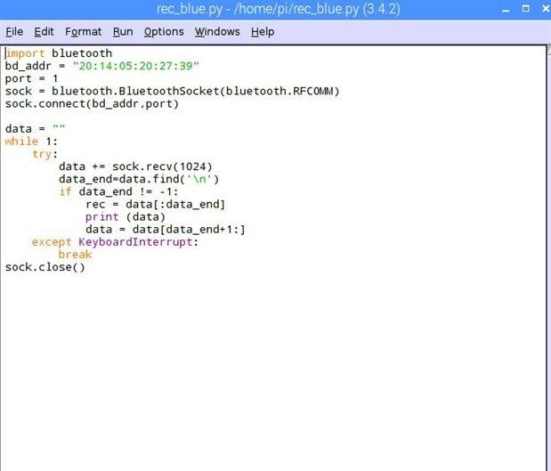

everyone, I am a new bee to raspberry pi. I am working on a project with arduino + HC-05 and raspberry pi 3

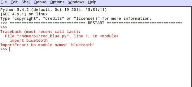

I have wrote a code to arduino to send temperature data to pi over bluetooth, and python code to receive the data. The python code throws error could not import bluetooth. Please can someone help me to rectify this...

    You need to install the bluetooth software onto the raspberry pi before you can use it. Open a terminal and enter the commands shown in this github repo https://gist.github.com/lexruee/fa2e55aab4380cf266fb
    one of them is sudo apt-get install bluetooth which would make sense

    0 naveenchand435 over 9 years ago in reply to e14 Contributor
    I tried that
    sudo apt-get install bluetooth, but that too didn't work,
    it took bluetooth as pybluez and installed its relavant files

    Here's something that might help understand why its not working, any Python modules that I download go into /usr/lib/python2.7/dist-packages There is also a folder at usr/lib/python3/ presumably any modules that you are going to import into a python3 script would have to go into the python3/dist-packages folder, it might be worth checking into this, if there is nothing in your python3/dist-packages folder that relates to bluetooth then thats probably causing the issues.
    from here https://docs.python.org/3/installing/ to import specifically for python3.4 do:
    python3.4 -m pip install SomePackage
    0 e14 Contributor over 9 years ago in reply to naveenchand435
    Hope fully this is the last post and solution image
    after following the steps in the link I posted above I did the following
    sudo python3.4 -m pip install pybluez
    this succesfully allowed me to import the bluetooth package in python 3.4, for python3.5 try:
    sudo python3.5 -m pip install pybluez
    don't forget to do it as root (with sudo). If this fails to work I can only assume that pybluez hasn't been ported over to python3.5 and you are out of luck
