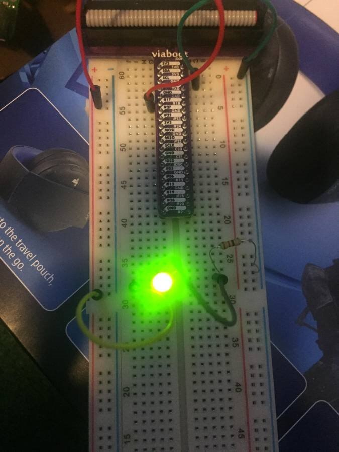

I am currently trying to turn an LED off but it is not working. (LED is always on, yes I do have a resistor 220 ohm)
I have Wiringpi installed and looking at the readall data I do not see any change when I run my commands.
I have tried directly in the python program, creating a python script and running it, running python from terminal, and using the wiringpi gpio commands. I have also tried doing all of this with sudo as well.

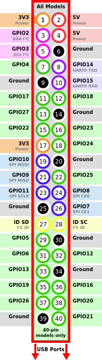

    You are using the numbering of the GPIO pins on the BCM controller rather than the BOARD numbers of the Raspberry Pi GPIO. The following chart does not relate to all Pi revisions, but should be OK for the Pi 3.
    So the BCM GPIO pin 17 (the one you are controlling) is actually Raspberry Pi GPIO pin 11. Could this be the problem? I notice that Pi pin 17 is a 3.3Volt pin which would light any LED via a resistor to Ground.

    I have tried using GPIO.BOARD and changing pin 11's output to False and nothing happened.image
    I have tried flashing the LED as well and it didn't do anything.
    i have found out while targeting other pins and reading the readall data that I am able to change all the gpio pins modes, but some i cannot change the output. 17 for instance will not change from 1 to 0 but the rest do.
    I have moved over my jumper wire from 17 to all other pins but nothing happens. If they're off and I turn them on the LED doesn't come on, and vice versa if they're on by default and I turn them off the LED stays on

    Another theory.... Could it be that you have the cable between the pi and the breadboard inverted? The side of the cable with the red pin goes FURTHEST away from the USB and ethernet connectors.
    • Reject Answer
  • byrd
    0 byrd over 9 years ago in reply to rew
    The ribbon cable was inverted..... Wow that's completely my fault for not reading the instructions clear enough, I just went back and read them and it says which side should be where.
