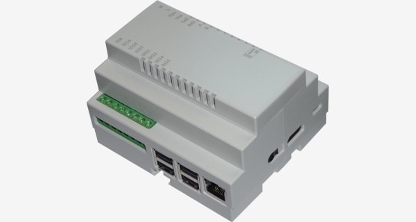

Hi,
I have developed a new enclosure for the Raspberry Pi. Integrated features include a powersupply, IOs, RS232 and RS485 ports.
The projet is now live on Kickstarter:
https://www.kickstarter.com/projects/572628401/dinrpi-din-rail-mountable-enclosure-for-raspberry

    Couple of points:
    • The 5V/1A solution is barely enough for practical use.
    • Your Din looks a lot like https://www.rapidonline.com/phoenix-contact-rpi-bc-raspberry-pi-din-rail-enclosure-563669 at higher costs(?)
    • What relay are you using? Since this does not allow higher voltage that other dins already support, I would stick to IOT2020 from Siemens.
    These are my views here. Good luck on your project.
    Clem
  • dinrpi
    0 dinrpi over 8 years ago in reply to clem57
    Hi Clem,
    Thank you for your feedback!
    I measured the powerconsumption of my RaspberryPi B+ with about 250mA! I also tested a RaspberryPi 3B with this powersupply and it works great. But you are right if you want to supply some external components you should choose the 5V/2A version.
    The phoenix contact solution does not have an internal powresupply or IOs so you can't compare the price.
    For the IOs I use SFH615 optocouplers because I think this solution is more flexible.
    Reinhard
