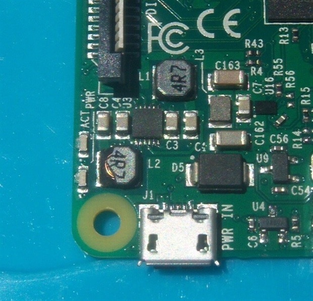

There is a broken chip on my Rpi3 motherboard labeled: 4R7. I just bought it and it broke while trying to install it inside the case. Will the board still work with that chip broken? Can I cover it with epoxy?
unsagicois
unsagicois over 9 years ago
There is a broken chip on my Rpi3 labeled: "4R7". I just bought it and it broke while while trying to install inside the case.
Will that chip: "4R7 being cracked will prevent the Rpi3 from working properly? Can I simply coat the chip with epoxy?
This is my first experience with Raspberry. I never heard of it before until I saw an advertisement for Cayenne in Facebook last month.

    You are thinking of a resistor. The resistors on the raspberry pi are mostly so small that they do not have a marking. There are however two inductors prominently marked "4R7".  Resistors cost factions of a cent, the cheapest inductors that I can find are about 10 cents.
    Most before me haven't mentioned it, but the cracked component is not a chip, not a resistor but an inductor.
    The two inductors are involved in the power circuit. They make, I believe, 3.3V and 1.8V from the 5V input. Because they step the voltage down, I can predict how they are wired. If the inductor is broken, one of those power rails will simply remain at 0V. This COULD damage one of the chips on your raspberry, but it is unlikely.
    The inductor consists of a wire wrapped around a core. If that core is cracked, the inductor will not work as well as it should. On the other hand, it is usually not all that critical in the power circuit, so if things change a bit due to the crack there is a possibility that things still work. The continuity of the wire is essential though. So... if you power up your pi, and it works, then that continuity is ensured. In that case encasing it with epoxy might work. On the other hand, if it fails after you epoxy it, it will be impossible to fix.

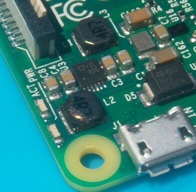

    Looks fine to me, just the package is broken. If the package is ferrite, the inductance will be slightly different. I don't think it's a big deal.

    I would agree with michaelwylie, based on the observed damage, as long as the windings are intact, the change in inductance could be compensated for by the power controller, it may run a little warmer but I would have fairly good confidence it will still work ok (If this is the only damage
    This should be fairly straight forward to replace if you are confident with surface mount soldering and if you can get the right part. Care would be needed to not damage surrounding parts or to get the board too hot. A hot air soldering gun would help here too.

    If the ferrite is cracked it makes sense to make the airgap as small as possible and keep it in place. Epoxy is fine for that.
    If the ferrite is broken that the body of the inductor is loose and it is just hanging on by the wires, then it makes sense to lock it in place. Epoxy is fine for that.
    But in the pictures it looks as if part of the ferrite broke off. In that case there is not much else you can do. Just power it up and see if it works. As michael says, the inductance may be a bit different, but they don't normally make anything between 2.2uH and 4.7uH, so even if they calculated the ideal value to be 3.7uH they will be using this one, and you dropped the inductance by a few percent. Nothing to worry about.
    Your measurement of 10 ohms is a bit high. Many multimeters cannot accurately measure low resistances. So there usually is an offset on the order of a few tenths of an ohm near zero. You can calibrate your offset by measuring the resistance from the SAME PAD of the inductor. Both leads on the same side. When you end up measuring the actual resistance you subtract what you got when you had the leads on the same side. I have one multimeter that has a 0.3 Ohm offset, but another has something like 5 ohms.
    Now... Even that 10 ohms reading can be considered "almost zero". 10 ohms is a tad much, but if we factor in about 5 ohms of offset on your multimeter, it doesn't sound too bad. Of course, for efficiency's sake, you would rather have 0.1 Ohms or less, but if that is unobtainable in the formfactor and/or pricepoint, then you'll have to settle for something less than ideal.
