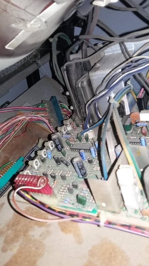

sso I have a lucky new lines arcade michine and I want a classic one not a slot so I want to put a pi in it but I don't know how. In the photo I think the red conectors are the imput wires please helpimage
    0 dougw over 7 years ago
    If you want to keep the old CRT, you just need to find the composite video input and connect your RPi to it.
    Most RPi's have a composite video output.
    If you need help identifying the composite video connector, start by finding the video card - it will be the card connected to the CRT. Post a closeup image of each connector on the video card. Someone here will be able to tell which is which...
