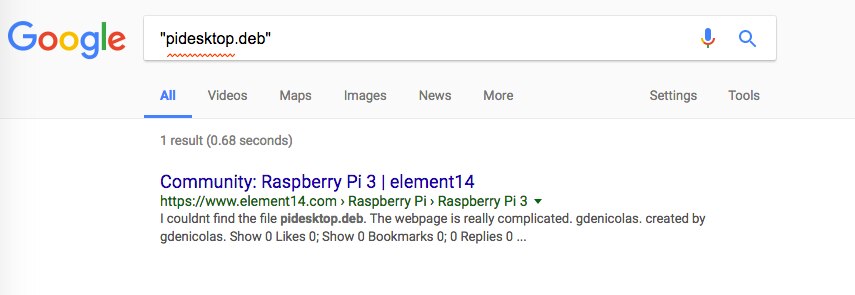

    0 balearicdynamics over 9 years ago in reply to stone1343
    You are true Jeff.
    I looked in detail to the product presentation page and it sound strange to me. The page was created in September 2016 and today the product is out of stock. But it is the first time I hear of this product just in this post; I was expecting a more intense promotion during the past months but this is obviously just an idea... No datasheet and no documentation at allo linked from the product page. Just the list of the features. Why?
    Searching on google the exact term pidesktop.deb (the debian setup file I suppose for the driver of this HAT) the only reference you find is just this blog posts ... Why? Maybe someone can give us information on how to ?
    I have already done a board to monitor the health status with some features; this project can be easily be applied to a PI HAT - and it is what I have in mind to do as I need it for several projects. The difficult it is not the powering of the system or the power-off the Pi, as well as a cooling fan controlled by PWM but how to Power-on the PI again after it was powered off. I have an idea but I am not sure it is the best solution in the world. If I am not wrong shabaz has already worked - at least in theory - in this direction...
