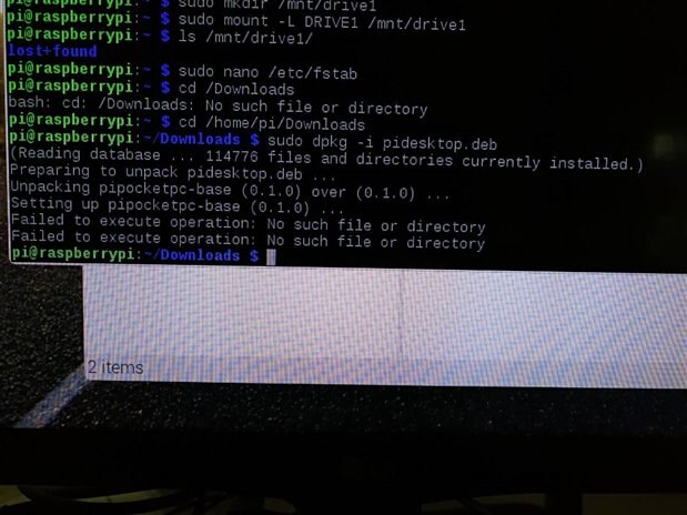

    I am still struggling to run pidesktop without errors.
    I have an sata drive 120gb connected inside the pi desktop.
    The error when I run pidesktop.deb is:
    "Failed to execute operation: No such file or directory" two times, as shown in the attached picture.
