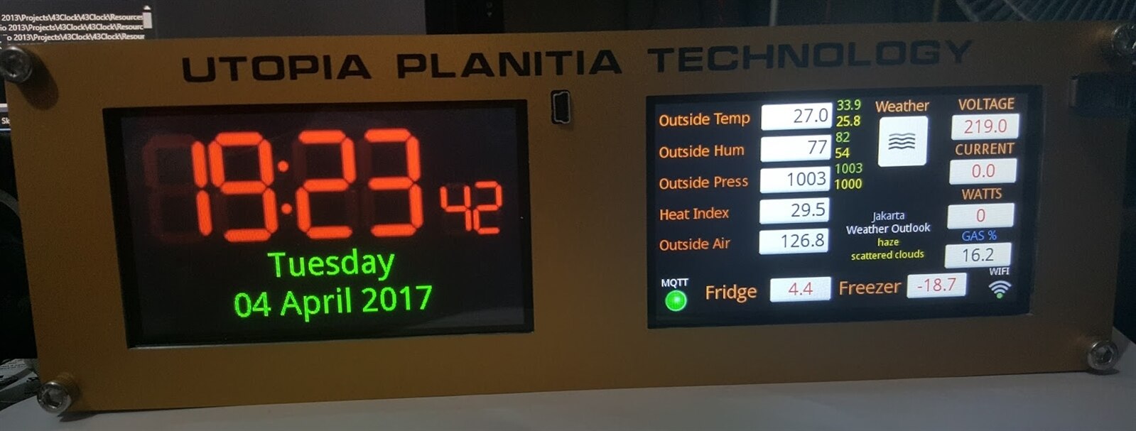

    A weather station is a good project and you can learn a lot by rolling your own and this what I used:
    ESP8266 as the weather station processor. BME280 for temperature, pressure and humidity and a dust sensor for air quality. Because of my location (20th floor of an apartment), no wind or rains sensors but they would be simple to add to the system. The DHT22 would be a poor choice and not very stable. The BME280 is little more expensive but has a super stable output. The Arduino drivers work on the ESP8266 without any changes.
    The ESP8266 talks MQTT protocol to a Raspberry Pi3 running Mosquitto and Node-red. Node-red acts as a basic web interface but I have a dual LCD unit with a clock on 1 display and the weather on the second display. Both are running a GHI Electronics G120 programmed in C# .NET Microframework. The software simply subscribes to the MQTT server and gets new data as the weather station publishes it to MQTT. In fact, any device on the MQTT network can get the weather data. It's a brilliant and easy protocol to work with and you never need to know the IP address of any of the devices on the network. The only requirement is that the MQTT server has a fixed IP address.
    By the way, if you use Node-red you can do the database logging without writing any Python code and just use MySQL. Simple Javascript coding within Node-red will be more than enough. Node-red makes life so easy. A great place to check it out is Peter Scargill's blog. http://tech.scargill.net
    This image shows the dual LCD display I have in my front room. The power data also comes from an ESP8266 on the network also sending out MQTT messages image
