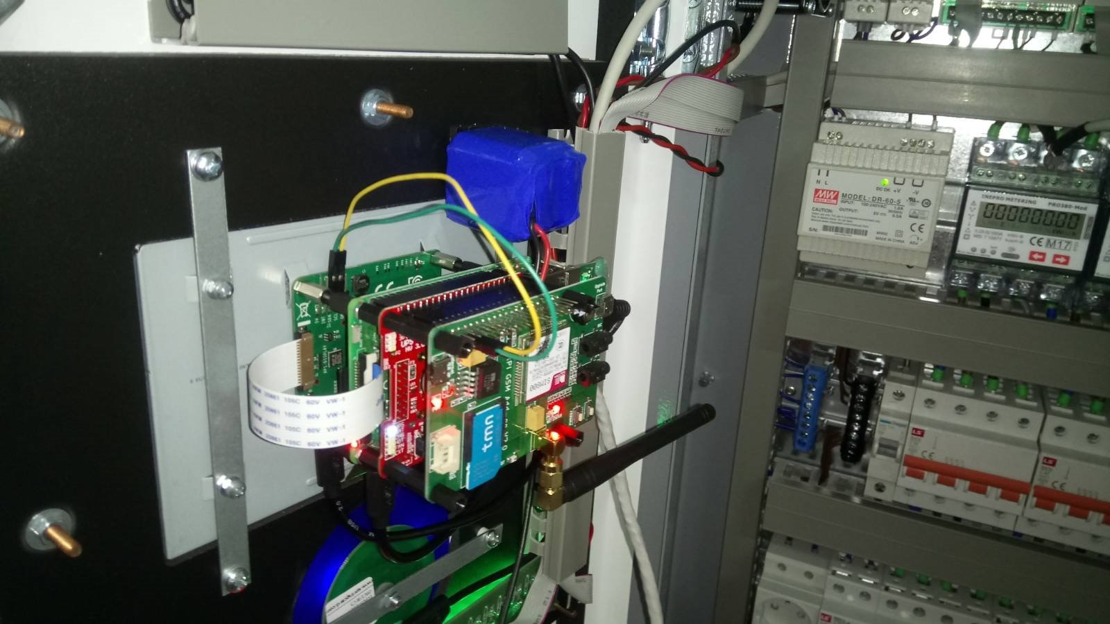

I have recently bough this display Raspberry Pi 7'' Touchscreen Display and got it to work just fine. The touchscreen works, the image looks great and i can control it with the Python module rpi-backlight.
However I stumbled upon a problem that haven't been able to solve so far.
I'm setting up a kiosk that contains this display, a raspberry pi, a 3g modem and a ups (uninterruptible power supply). The ups module is used to power the raspberry and the 3g modem so that on a power failure, the kiosk can perform some operations, send some data through the 3g connection and perform an orderly shutdown. In case of a short (in time) power failure, the UPS module is smart enough not to shutdown the system.
The problem that I'm facing is that on a power failure as the monitor is not connected to the UPS, it will shutdown but when the power returns the monitor will not turn on again. The screen stays blank as in no image, no power, no backlight. To make the monitor work again I have to turn of the UPS system, power off the raspberry, power the display, and then power it on all again. If someone has a monitor like this it can replicate this problem by simply powering the monitor off and on again keeping the raspberry on.
After spending some time trying to solve this problem I learned that this monitor can receive I2C commands, however I been unable so far to find out the command codes and/or how to send it a "power on" command if it even exists.
The Python module rpi-backligh as the functionality to turn the monitor on and off which works great at start, but won't do anything after the monitor shutting down due to a power failure.
My setup is:
Raspberry Pi 3 Model B v1.2
RPI SIM800 GSM/GPRS ADD-ON V2.0
UPS PIco HV3.0 - Uninterruptible Power Supply & I2C Control HAT
For OS I'm running Ubuntu MATE 16.04.
The OS is fully updated (sudo apt-get update, sudo apt-get dist-upgrade) as the raspberry firmware (rpi-update).
Does anyone have any idea of how to overcome this problem? Or a list of the I2C commands that this monitor can receive?

    The screen and Pi are normally powered from a single source. The Pi gets powered via the screen's USB output or via the GPIO, meaning you can't power on or off one without the other. See Raspberry Pi 7” Touchscreen Display .
    Is this different in your case?

    0 shabaz over 9 years ago in reply to francisco.vaz
    Could you explain with a diagram, because there is conflicting information.
    I'm guessing you're trying to describe some brownout scenario, but it is unclear. A diagram will speak a 1000 words.
    Anyway, if there is a brownout scenario, the issue lies with the UPS.

    The UPS that I use (UPS PIco HV3.0 - Uninterruptible Power Supply & I2C Control HAT) connects directly to the raspberry through the GPIO ports meaning that it will not power the display, only the raspberry.
    On the picture you can see (from left to right) the display, the raspberry, the ups module and the 3g modem. That blue "box" is the ups battery. On the back with a green led you can see the power supply that is being used to power all of this.

    Yes, I am describing a brown out scenario where the ups keeps the raspberry powered for some time for it to perform some tasks before shutting down.
    However in the case of a short (in time) brown out if the UPS does not need to shutdown the system, the display will not work again.

    I'm afraid you need an engineer to investigate, because there are misunderstandings here. When you say "it will not power the display, only the raspberry" I don't think that is what you mean, but it is unclear and I can't see where all the connections go in the photo. Whoever designed this for you can sketch a diagram, or diagnose this.
    I don't know if by a short time you mean a glitch, or some other time period before the software determines that a controlled shutdown is needed.
    Personally I would solve it with 'OR'd power supplies (one of them would be derived from a battery being trickle charged) but different engineers may implement things in different ways.
    You could also investigate a different vendor UPS, i.e. one that functions as it should and support brownouts. Bicker UPSIC-1205 might be interesting, I've not tried it, but it looks ideal. It has 12V output so you'd need a 5V DC-DC converter too.

    On the picture, the red board is the ups, the blue battery is connected to it so there is no power going from it to the display, only to the raspberry and the 3g modem.
    When I say "it will not power the display, only the raspberry" what I mean is exactly that i.e. on a black out, the display will stop being powered but the raspberry will continue being powered by the UPS for some time. A short black out yes, could be a glitch on the power network, say a 5 seconds power failure. When this happens the monitor will shut down because is has no power, but the raspberry will continue being powered by the ups and as the ups realizes that the power is back, it will not perform the controlled shutdown because id deemed it unnecessary. On this case, the monitor will not display anything again until a full shutdown.

    From the comments and the picture, my guess is that things are connected as follows:
    If that is correct, you could try the following:
    * remove the power input of the display
    * connect the display's power GPIO pins to the top HAT's power GPIO pins
    Assuming the UPS can handle the extra load, this will power the screen from the UPS' GPIO header, just like it powers the Pi and GSM HAT.

    No worries. I think I understand a bit more now. The red board is connected to the Pi so the UPS is powering the Pi during a failure scenario.
    You have two USB supplies connected; I can see a black cable going into the Pi, and a black cable going into the display board.
    So, you have no power at all to the display during the failure scenario.
    The red UPS board may not be able to power the Pi and the display, I don't know the specs of it. If it can, then you can run red and black wires from the 40-way connector 5V and GND pins respectively, from the top board (the 40-way connections are all wired through the boards sandwich) to the display board, and remove the USB connection from the display board. You probably need to confirm with the source of the red board, if it was tested with such conditions (i.e. with display, and with glitches and possibly varying voltage briefly). Anyway it is worth a try.
    If that doesn't work, it may be best to look for a different UPS solution that can handle the display and the Pi, if a software solution to perform a reset of the display cannot be found.
