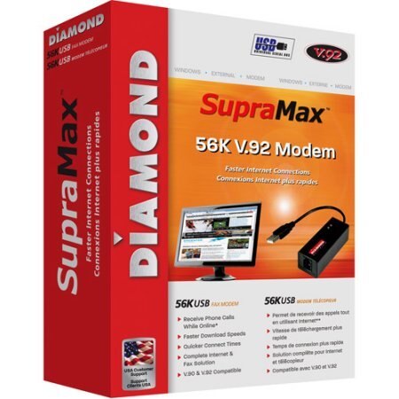

    Wow thanks guys for all the info,  first I guess I should mention the connection would be to a gsm home phone wireless unit.  but would not have data capabilities.
    Similar to this one here.
    I do also still have my USB-to-RS232 adapter laying around not doing anything as well.
    This is the usb 56k modem I was hoping to use but I have other usb ones as well so hopefully something would work.
    And then would create a linux dial in server on the collection terminal.  Still lots to work out for sure but greatly appreciate everyone input here this is awesome! Thank you all.
  • clem57
    0 clem57 over 8 years ago in reply to gam3t3ch
    Looks like a good idea. But do not use WinModems that use software drivers in windows to make them work
