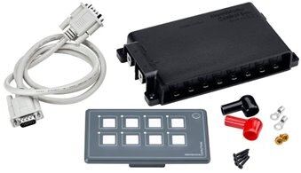

Hi im helping out my father that sits mostly in a wheel chair. Trying to build a app interface to this switch board (picture 1).
I am not any programer, but i am trying to learn. My question is, can i use a rasberry with the adapter (picture 2) and a vga splitter (picture 3).
And How image. sorry for the bad english. Thanks, John from norway.

    That looks like a marine control panel and relay box:
    SP5030-8P Membrane Touch Control Panel - High quality SP5030-8P Membrane Touch Control Panel manufacturer from Taiwan, C…
    Are you:
    • trying to replace the touch panel with the R-Pi ?
    • trying to replace the relay box with the R-Pi ?
    • trying to insert the R-Pi between the two ?
    Is the cable between the touch panel and relay box definitely terminated with 15pin connectors ?
    The adapters you show are VGA video adapters.
    (2) looks like a VGA666 module which is designed for using the GPIO of the R-Pi as a video  output.
    https://www.seeedstudio.com/Raspberry-PI-VGA666-DPI-dtoverlays-Module-p-2730.html
    It looks pretty much like a pass-through but does have several additional components on it. You would need to work out the pin to port mappings to find which GPIO pin each pin maps to. You may be better off making your own VGA breakout adapter though.
    There is a schematic of the VGA666 here which shows the mappings:
    https://github.com/fenlogic/vga666/blob/master/documents/vga_manual.pdf
    You would also need to work out what the connections are on the control box. One is likely to supply power to the touch panel so you need to be careful which pin that ends up on. Likewise you will need to work out which voltage levels the remaining pins operate at. This assumes that the control lines are some sort of digital IO or closed contact and not a serial connection such as RS-232/RS-485 or perhaps CAN BUS.

    Thanks for the information. trying to insert the R-Pi between the two, so we can use the touchpanel inside the boat driving. and a bluetooth app for outside driving. il try mapping out the connector tommorow.
  • beacon_dave
    0 beacon_dave over 8 years ago in reply to pjho
    ok, if this panel is used to drive the boat then you need to start thinking safety.
    The VGA666 could still be used by cutting the existing PCB tracks and using it as protoboard by soldering directly onto the connector pads.
    Depending upon your skills you may find a couple of generic VGA breakout boards are easier for you to get started with than the VGA666 board:
    http://site.gravitech.us/MicroResearch/Breakout/DB15F-VGA-TERM/DB15F-VGA-TERM_3R.jpg
    https://www.adafruit.com/product/3124
    https://www.adafruit.com/product/3125
    At least initially to allow you to probe the signals between the touch panel and the relay box, and then later to allow you to prototype with.
    You can buy some 15pin hi-density D-sub type connectors  and make your own however.
    Alternatively you could buy a cable and cut it in half to access the signal lines. Not all VGA video cables have all 15 pins wired however and some are 75ohm coax.
    You may find that there are some active electronics on the touch panel itself which means that the button indicator lights are controlled by the panel rather than the state of the relay box. This may make it difficult to reflect the state of operations whilst under Bluetooth control via the R-Pi. However depending upon the requirements you could perhaps power off the touch panel whilst under Bluetooth control and then restore power to the panel once the Bluetooth is disconnected. However that may cause issues as if the panel defaults to all outputs off upon power-up as you may find yourself in a situation with no lighting at night until you can reach the touch panel to turn them back on.
    It may be easier to do this project if you can find a marine control panel system that is already designed to work with two touch panels. The R-Pi then replaces the second panel and the relay box takes care of keeping the first panel synchronised with the actions performed over Bluetooth.

    Can you provide a description of the project?
    I want to.......
    The parts collection image doesn't provide details needed for a response. Describe in general terms what it is you are trying to accomplish. Include the Pi type (ie Pi3B+) and what the black box unit is, make manufacture, part number. The white cable could be serial or VGA, hard to tell, how many pins. It looks like three rows if I zoom. That would suggest VGA.
    There are some accomplished makers in the community. They may have a solution to your problem if you can provide the details. Don't be concerned about the language barrier, try you best. The community members will work past the language barrier.
