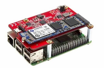

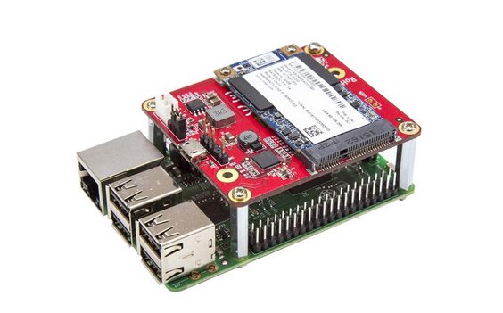

    0 e14 Contributor over 8 years ago in reply to beacon_dave
    Making a mounting bracket may not be necessary.  There are mSATA/USB stackable boards for the Raspberry Pi.  Here are 2 examples from https://www.startech.com/Search?search_term=msata+raspberryimage
    Obviously, you can't stack inside the pi-top enclosure but the screws seem to line up with the Raspberry Pi which mounts magnetically on the rails.  It would appear that the mSATA cards could mount the same way.  I just need to go to a store which has a display pi-top model and verify that there is enough left over area for an extra board - should be - and an mSATA card can mount the same way.  Maybe, I can talk them into letting me try it out with the display model before purchasing.
    Make sense?
    Hopefully, there is enough power running on the battery as well as off a wall socket.  Running off a battery for an SSD (non-mechanical drive) should be okay.  Other opinions?
