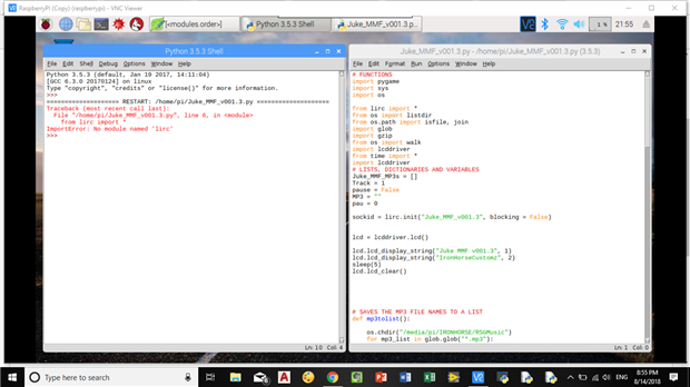

OK i know this is probably a total newb  question but i am a new. I have RPI 3 B+ and im creating a mp3 player as a project for my intro to electronics engineering course. Ive downloded lirc created my remotes profile and all is working on that end but when i try to import it into my program (written with python 3)  i get "ImportError: No module named 'lirc'". SO what am i doing wrong? everything went as smooth as it could setting the remote up and i cant find anything on the web about why it wont import so im hoping someone here can help or give me advice at least. thancks in advanceimage

    Did you do
    pip install python-lirc
    to install the python package?

    I used sudo apt-get install lirc
  • mconners
    0 mconners over 8 years ago in reply to rgiguere
    Well, you need to install the python module, that's why you can't find it when you import.
    Follow the link I attached above and do what it says and it should solve your import problem.

    OK now im able to import lirc  but when i run the command
    import lirc
    sockid = lirc.init("juke01", blocking=False)
    #lirc.set_blocking(False, sockid)
    print(lirc.nextcode())
    lirc.deinit()
    it just prints []
    it doesnt actually print the key name

    I've never actually used lirc, but looking at the example on the page I linked, It looks like
    the init line needs to match the prog line
    so replace
    with
    sockid = lirc.init("Juke_MMF_v001.3", blocking=False)
    and I don't really know if the button names you have in the config are valid.
    There is a simple example on the linked page as well. I would suggest copying that verbatim and make sure that works.

    Thanks for everything Michael im glad ive finnaly found a forum where people dont just throw answers at you! So aparently there are a few different versions of lirc for python depending on what version of python you are coding in depends on what version of lirc you need the original lirc only support linix and to make it work you must install pylirc for python to act as a so called middle man to communicate between the 2. For python2 use pip install python2-lirc and for python3 pip install python3-lirc as these 2 contain binders for python built into them last but not least when initializing  lirc sockid =lirc. init("prog", blocking=false) where prog is the name of your program you are running NOT THE PROGRAM FILE OF THE RWMOTE.  As i made this mistake but everything is working as it should.
