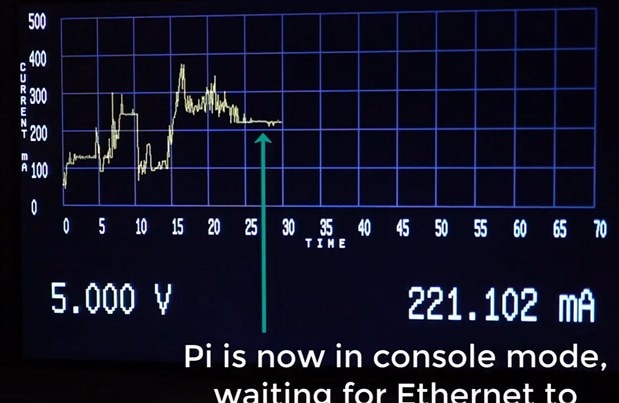

    0 shabaz over 6 years ago in reply to fmohammed2019
    Hi Falah,
    It varies versus time (and load). It is not constant.
    See below for a screenshot (time in seconds on x-axis) for the boot-up sequence for a Pi 2B. The Pi 3B has very similar current consumption, except when under load.
    Some figures for different typical loads, and the delta for WiFi, are here:
    https://raspi.tv/2016/how-much-power-does-raspberry-pi3b-use-how-fast-is-it-compared-to-pi2b
    You battery would need to be capable to supply 5V at around 400mA current at least (and preferably more, because with heavy loads this will be insufficient).
    You can see from the screenshot above that it peaked briefly very close to 400mA just during startup.

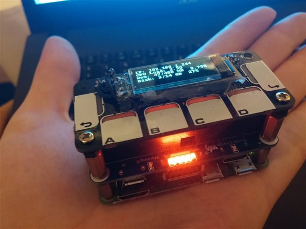

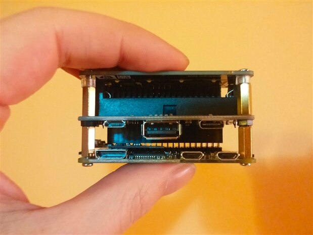

    0 cypresstwist over 6 years ago
    This might work: Li-Ion Battery Hat from Waveshare. It uses a 14500 battery but you can connect more to it. I'm using it with a Raspberry Pi Zero W, a Touch PHAT and a small OLED screen I've soldered to the board. Lasts about 3 hours on idle.
    I think it might be able to power a 3.5” TFT.
    • Reject Answer

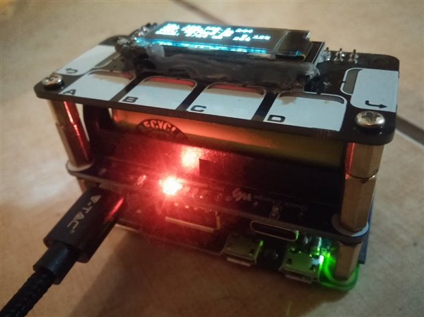

  • cypresstwist
    I had a 3.5” touchscreen TFT laying around and decided to try it out. It works. Video below.
    This is with only one 14500 battery but two should give you double the time. My guess is one such battery with this HAT should be enough to power the Pi+screen for an hour.
