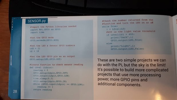

Bought the Pi today with the kit, however am struggling whit the code. I can not for the life of me why I keep getting "invalid syntax" errors on line 27.
import RPi.GPIO as GPIO
import time
GPIO.setmode(GPIO.BCM)
LED = 21
LS = 18
GPIO.setup(LED,GPIO.OUT)
def LSval (LSpin):
    reading = 0
    GPIO.setup(LSpin,GPIO.OUT)
    GPIO.output(LSpin,GPIO.LOW)
    time.sleep(0.3)
    GPIO.setup(LSpin,GPIO.IN)
    while (GPIO.input(LSpin) == GPIO.LOW):
        reading += 1
    return reading
while True:
    i = LSval(LS)
    if LSval(LS) > 400:
        print("Dark",i)
        GPIO.output(LED,True)
    else
        print("Light",i)
        GPIO.output(LED,False)
@Element 14, plz keep your documentation accurate. The booklet, in this case, is wrong.

    Perhaps it should read else :

    Yes, it turns out that is what it was.
    Thanks!
