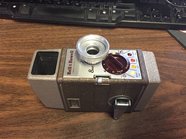

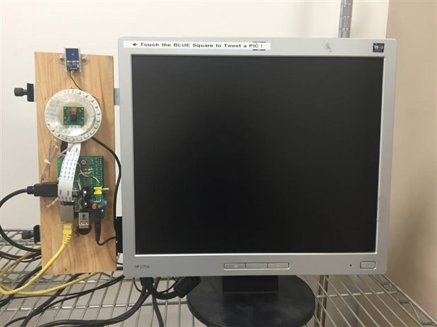

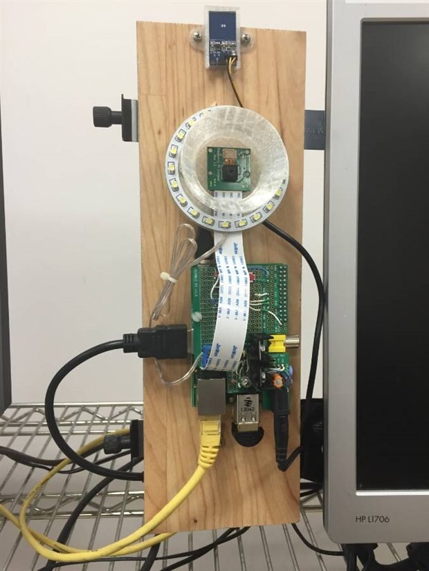

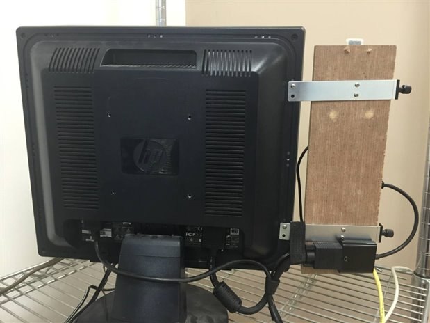

    I made a couple of these rpi based tweeting photo booths.
    http://www.nutsvolts.com/magazine/article/march2016_RaspPiDigitalPhotoBooth
    its driven by a single python script using pygame. real easy to change.
    should be easy enough to change from stills to video clip....
    First one was ugly but worked.
    I used a ring led as a "Flash"

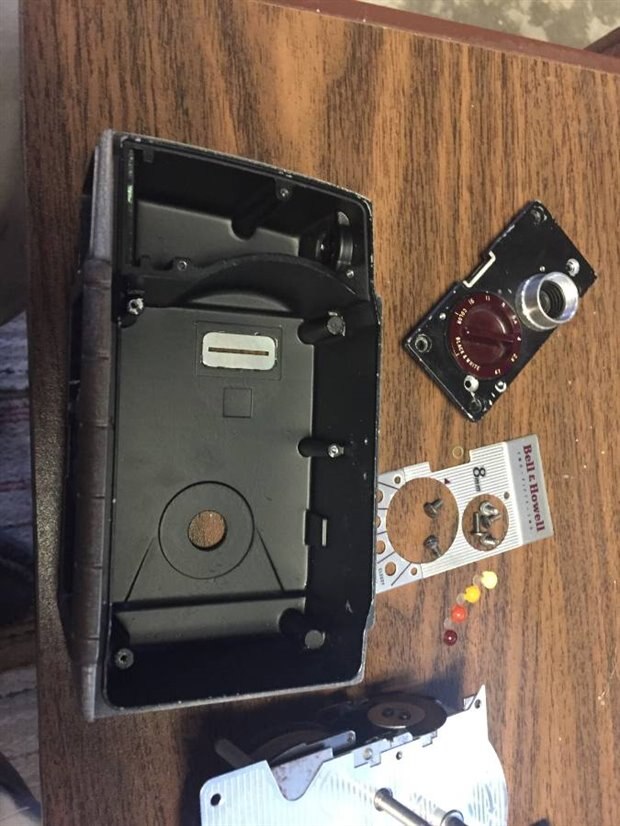

    My latest case  is more elegant
    A gutted bell and howell movie camera
