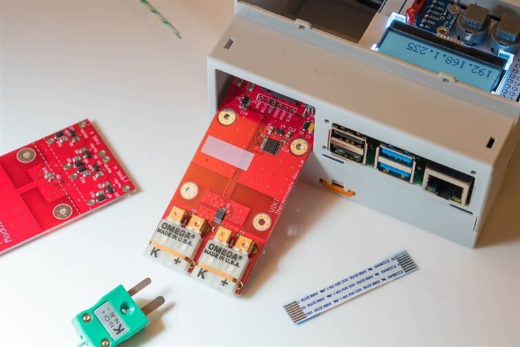

I am interested to know what experience others have had using a Raspberry Pi in industry?  I would love to hear about:
  • Any issues with short and long term reliability?
  • Connectivity with Industrial control systems -
    • Have add on boards been used?
    • Have custom PCB's been made to interface 24V based I/O on PLC's / DCS systems etc?
    • How has it been hooked up to power?
  • Issues with EMI?
  • Long term SD card reliability?
  • Has a Pi been used to actually control some industrial equipment rather than for monitoring or HMI?
  • What version of Pi was used - eg. Compute module
  • Why use a Pi vs a PLC or industrialised PC?
  • What were the biggest challenges?
  • Was there any challenge from peers or management in using something that could be viewed as an educational tool rather than industrial control equipment?
  • What OS has been used?
  • Have there been any concerns around security? Especially if connecting to a Process Control Network.
  • What security precautions have been taken?
I can see lots of advantages to using a Pi in industry - for example the amount of power and versatility for such a low cost!
Even if you don't have experience using a Pi in industry - it would still be great to hear people points of view!
I look forward to some interesting responses!
Tony

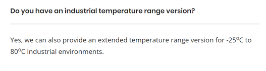

    Interesting board (MyPi). I think the literature is a bit misleading though, they state:
    however they don't qualify it. I guess that version comes with a fan or heatsinking (which is harder on a SIMM module).
    The netPi is a more believable 50 deg C, and they explicitly state that this is supported without throttling, and their extended range is up to 60 deg C.

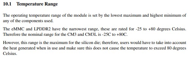

    My understanding is that it is the components that are used that are extended temperature versions. I agree that the literature is a little misleading.
    As stated in the Compute Module data sheet this would be the max for the silicon die and does not take into account heat generated by itself....
    Of course, not all industrial uses are subject to extremes of temperature so this may not necessarily be a critical requirement.
