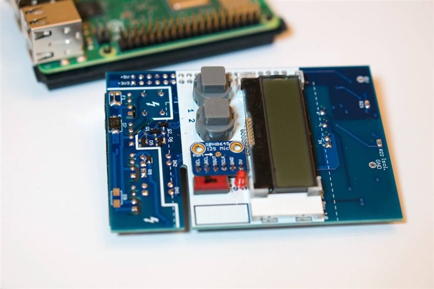

    The versatile intelligent controller (V.I.K.I.) is progressing.. Here's the (still-to-be-tested) main-board.

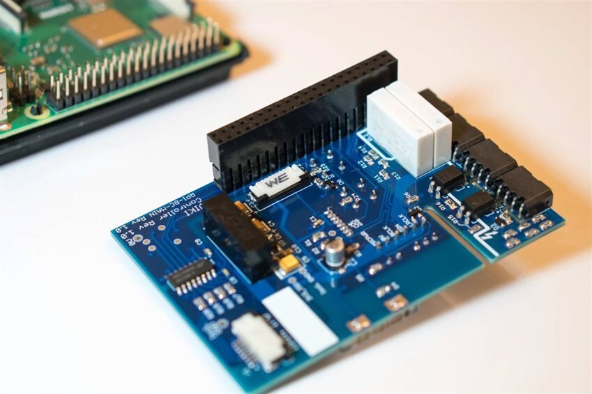

    Other side of it..

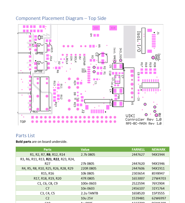

    There will also be a print-friendly assembly guide (screenshot below) with details and part codes so anyone can make it.
    Currently I've been taking notes of where the assembly instructions could be better, and where the PCB layout could be improved, so there will be a rev 2 PCB, and schematics/gerbers will be published.

    Thanks for the interest, there's a blog post here that covers the main board in some more detail:
    VIKI (Versatile Intelligent Controller for Industry) Schematic, Bill of Materials and Component Placement Diagrams
    The main board has two optocoupler inputs and two relay outputs, and a user interface. There's also some basic software (C and Python I think) that can be used to send text to the LCD screen, and to read/write to the inputs/outputs. These can be combined into scripts for instance. It's been tested on Pi 4 and all that functions currently.

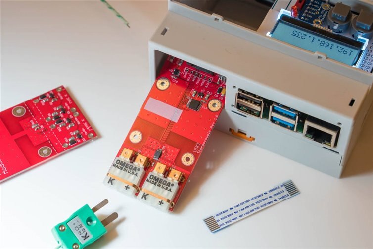

    Recently I've been working on the first add-on interface, which adds two thermocouple inputs.
    That still needs to be tested:
