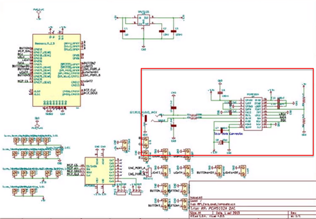

    Hi Madeline,
    From the video, it looks like they are using a PCM5102A chip for audio, musically it will perform like any other audio card for the Pi, because they nearly all use this chip.
    I've not seen the board, so I have no specific feedback related to it, but I've used that audio chip, and it's comparable to an ipod (no better or worse I think).
    The physical difference between the kickstarter board and existing audio boards is that it also has input/output features. They may also have software features but I didn't explore the kickstarter page in detail.

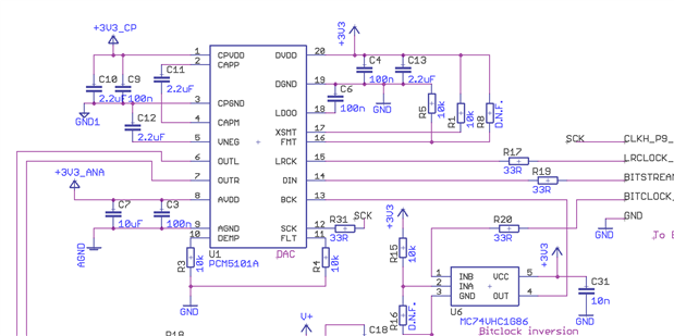

    0 shabaz over 7 years ago in reply to michaelkellett
    Hi Michael,
    It was a screen capture from their video, but due to its low-res I couldn't tell what was on the left side, maybe a microcontroller and I/O expander.
    I recognised the DAC pinout though, here's the schematic from a BeagleBone Black project, the PCM5102A is the replacement (pin-compatible) for the PCM5101A:
