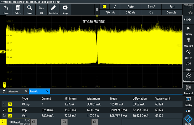

    0 baldengineer over 7 years ago in reply to rew
    I Had set the current limit to 1.05A (5.4W),  and  my power supply at one point in the boot process decided: That's more than 1.05A, you can go... (all this while the average current is now under 600mA).
    About a year ago I measured the current draw of a Pi 3 using a current probe on my scope. In this attached shot, you can see there are >1 Amp transients. This measurement was like a PS1 emulator was running Final Fantasy 8. I thought I had one from the boot process, but I cannot find it at the moment.
