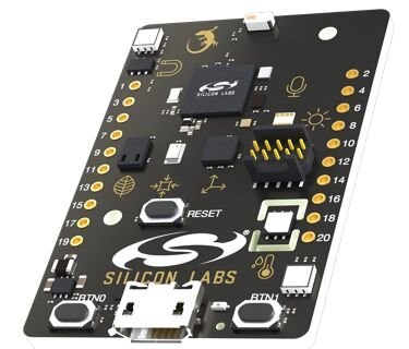

    Thunderbird Sense 2 is one of my favorite : https://www.silabs.com/products/development-tools/thunderboard/thunderboard-sense-two-kit
    This small piece of PCB has a handfull of sensors integrated to it. This will give you an idea of how to develop your own designs.

    take a thunderboard sense2:
    Connect any of the GPIO (Gneral purpose Input Output). To the pin 2 of DHT11. Connect 3V3 to the VCC pin (pin 1) and ground to Pin GND(pin4).
    Now you need to generate/detect "1" and "0" of required duration on the GPIO pin inorder to retrieve information from the sensor.
