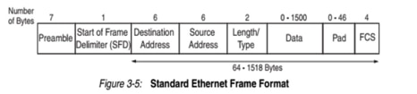

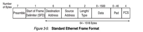

    0 nithinrahav over 7 years ago in reply to michaelkellett
    Hi,
    For now, could you please tell me how to read ethernet packets(MAC level) in Raspberry Pi.Is there any driver for this thing?As I mentioned before,Xilinx provides an IP which is capable of sending MAC level Ethernet packet.
    https://www.xilinx.com/support/documentation/ip_documentation/tri_mode_ethernet_mac/v9_0/pg051-tri-mode-eth-mac.pdf (Ethernet MAC IP).

    0 rew over 7 years ago in reply to nithinrahav
    By putting the right bytes in the first few bytes of the packet, you can turn an Ethernet frame into an UDP packet. Now receiving those packets on Linux becomes easy.
    For starters, it would be good practice if you could get sending UDP packets from your Linux PC to the raspberry going. Just as a step in gaining experience with the whole "networking" field.
