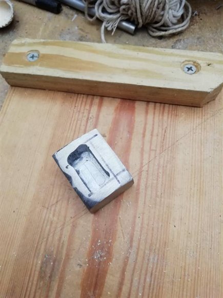

Just got a Pi4 for a project and noticed that it got hot within a few minutes and that's before I've even put it into a case. Has anyone done a DIY heatsink? Can I reuse something from an old PC? Are all the chips electrically isolated and at the same physical level? I also want to use an audio hat with this, so am looking for tips for extending the 40pin GPIO header.

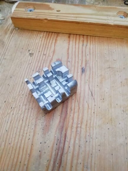

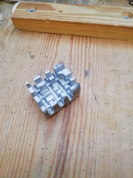

    So I had a little block of aluminium and I drilled some holes in it and joined them together with a saw. I'll give it a test in the week to see how much heat it dissipates.
