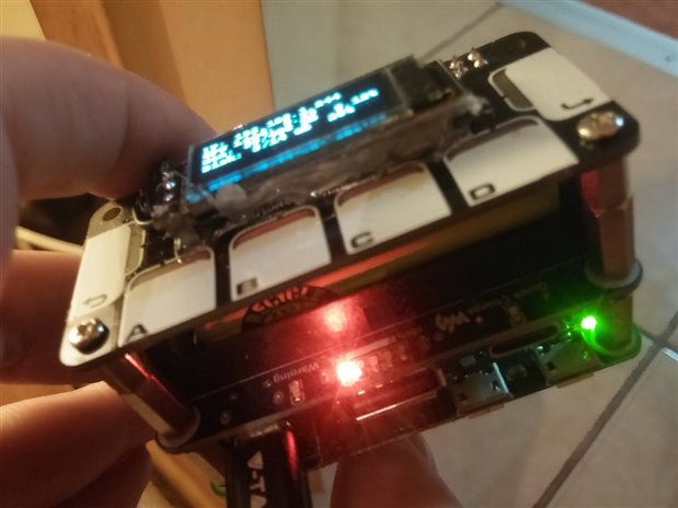

    0 cypresstwist over 6 years ago
    I use a Waveshare Li-Ion HAT on my Raspberry Pi Zero W. About 2 and a half/3hrs battery time on idle. Maybe more. powering one Touch PHAT and an 128x32pc OLED screen that is always on. It uses a 14500 battery but you can connect more to it (of what I read).
    Also see this video I've made for another thread:
