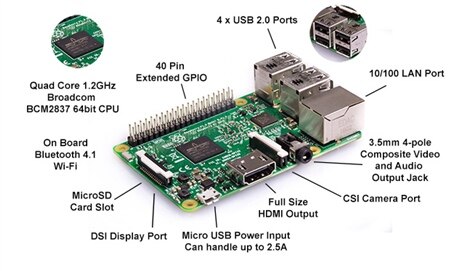

    So, I happen to have my own Dell 2007fbp monitor.  It's an old model, I rescued it from the recycle pile.  And I rescued it for use with an rPi because it has a composite port:
    https://www.dell.com/downloads/emea/products/snp/UltraSharp%202007FP_EN.pdf
    And all raspberry pi models have a composite port.  Resolution won't be very good, but it would make your rPi usable.  With the newer Pi models, it's a bit more difficult because you'll need a 3.5mm jack to composite cable.

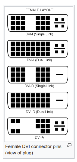

    If I am reading correct, the monitor has a DVI type connector and you are using a HDMI to DVI?
    Can you tell me what DVI connector is on the monitor?
    I may be taking you down a path that is not valid but here is my train of thought.
    I have HDMI to DVI cables. The DVI connector is third from the top. I'm have on order a adaptors HDMI female to DVI connector at the top.
    Do these connector impact a monitors ability to detect a device. Again I'm just thinking out load.
  • kse001
    0 kse001 over 6 years ago in reply to colporteur
    The monitor connection and cable I was using are both dual link DVI-D.  I'm not totally sure I understand your question/statement, so I may not be responding to what you meant, but I don't think the connectors come into play with this.  My reasoning is that things did work initially, right up until I disconnected everything and moved it to a different room in the house.  Also, I connected an Intel NUC using the same HDMI-DVI cable I'd used with the Pi when it worked and got a signal.  Plus the fact that the new Pi is now working with everything else being the same seems to support that.  With all that having been said, though, I definitely don't claim to know enough about this to say one way or another with any authority.  I'm just going on the testing I did and how I interpreted the results.
