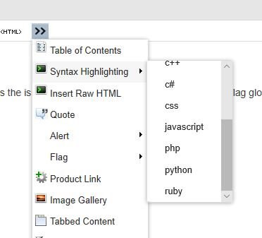

    A global variable can be defined in Python but it is not clear to me that is the issue.  Try making the variable to be used as a flag global and if that doesn't work post your Python code with as much of the superfluous removed as you can that still demonstrates the issue.  It will be easier to read if the Insert tool with syntax is used:
