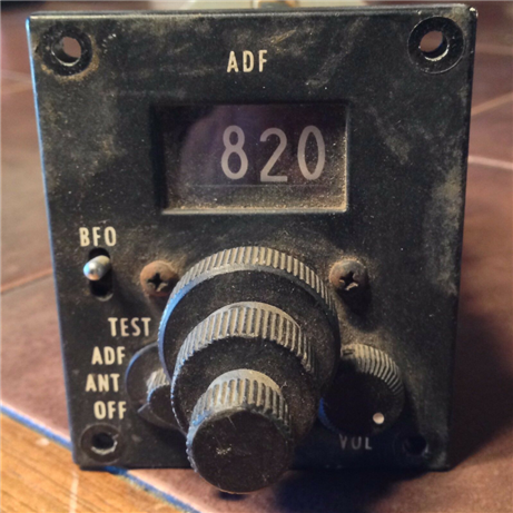

Here's the twist and where I need to help getting started. I have 5 of these 80s analog, precise, unused instrument controllers. I would like to incorporate these to replace the stock rotary dials and control channel and volume. It would look cool, be original, but.... I don't know how to use the controller to feed inputs to the RP.

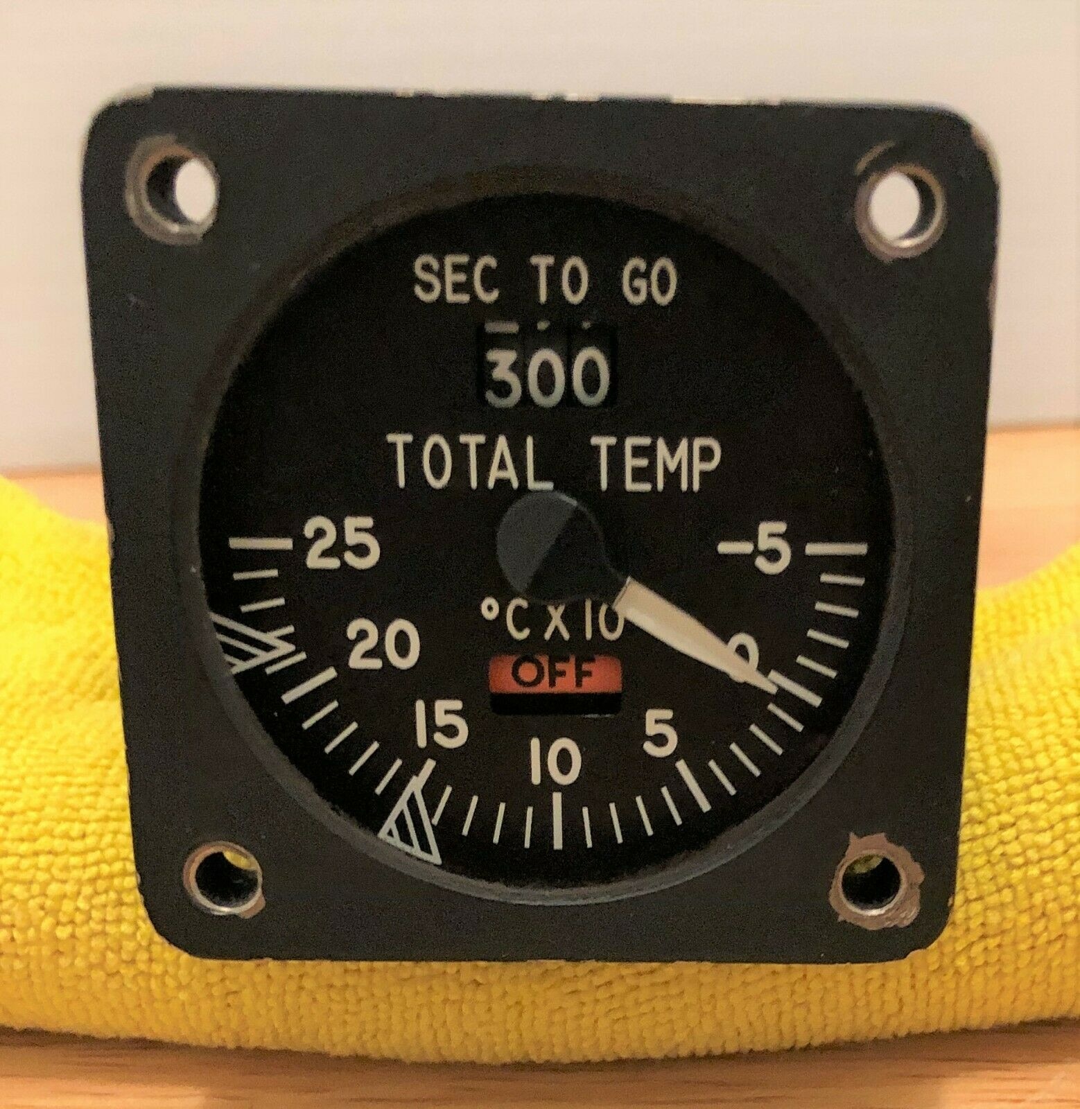

Expanding the project, I could even add some electric dial powered instruments/gauges to show volume level setting by feeding the right input back to the instrument.

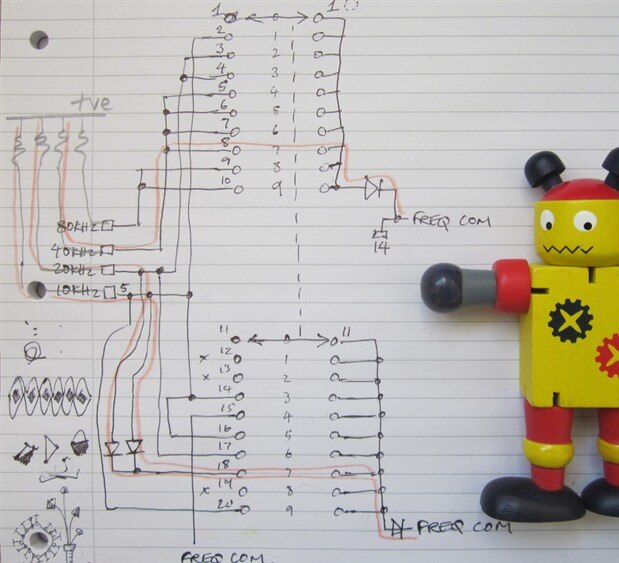

    In case you're not clear about the schematic, the frequency switches encode negative-logic BCD [Binary Coded Decimal].
    One slight disadvantage with the scheme that the original designer used is that, on the setting for '7', there are two diodes in series on a couple of the outputs, so the drop across them is going to be a fair bit more than where there is just one diode, and the corresponding low-level will then be higher. You might want to measure that voltage level with a meter and then take a view as to whether you were happy with it for whatever logic it was going to be connected to.

    0 phoenixcomm over 6 years ago in reply to jc2048
    jc2048 you are sort of on the right track. but even you could say BCD it is not. But they do add like BCD. like I said a 700K = 400K + 200k + 100k. but the diodes make it crazy. like i said to build a spreadsheet for the three switches, as they all will be a little different. Connect Negative to the common and start switching and probing.    BTW since you are not pulling up the output lines, they will float.  the easy way if you don't want to probe is to connect a breakout with your LEDs and a resistor in series. then to 4 or 5 volts, and the grounded ones will lite. fins!

    I know you and Micheal have basically answered the question. I was just emphasising to Marco that the switches do the encoding, so if he's careful with how he arranges his IO, he can have the numbers by simply inverting the code that comes in.
    Here's how it looks if you redraw the two switch poles so that it's a bit easier to understand [I find the original a bit confusing, even though it's a very nice piece of draughting work]. That's for the 10s of kHz switch, but the same applies to the other two.
    I've shown the current flows in red for the case where '7' is selected. The extra diodes are necessary for that case because there are only two switch poles, but three lines need to be pulled down.

    0 michaelkellett over 6 years ago in reply to jc2048
    Hello John,
    You mentioned it earlier but your enhanced schematic (amazing app that PencilCAD ! image) really brings the point home - the diodes mean that the switches won't pull very low.
    For correct operation of the MCP23017 used in most I2C expanders you need to get below 0.2Vcc (0.66V on 3.3V systems, 1V on 5V systems).
    The two diodes in series mean that 20k and 10k will pulls down to about 1.2V (if silicon diodes).
    You could still use the MCP23017 but the 10k and 20k lines would need some additional components for it to work.
    Alternatively you could use a micro (an Arduino would do, a 3.3V one will interface mores easily with the RPi) and use its built in ADC to measure the 10k and 20k signals.

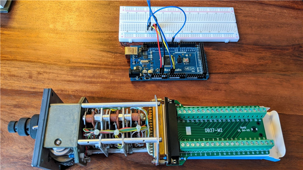

    Well I decided to go with phoenixcomm 's advice and also learn a little more, so I bought an Arduino MEGA kit, and followed enough tutorials to be dangerous. I have a little program that can read my 16 analog inputs on the MEGA Serial Monitor. Enough to start playing and read values. Once I have that down, I'll worry about porting them over the the Pi and the radio program.
    Now pls indulge me with another beginner's question : Now I need to map my pin# to the Arduino inputs. For the 10 Frequency selector pin I think I port each to an analog MEGA input. But how do I identify pin# for Ground and VCD ? I don't mind trial and error but I am afraid of frying something. Also for VCD should I start with the 3.3V or 5V feed from the MEGA ? I'm slightly out of my league here, perhaps my question is not even the right one.
    Thanks !
