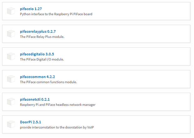

    pip3 install pifacecommon
    Here are the other modules: https://pypi.org/search/?q=piface

  • cstanton
    0 cstanton over 6 years ago in reply to davinha
    As you will have seen at https://pypi.org/search/?q=piface  the emulator and scratch handler are not pip packages.
    There's nothing I can do about this.

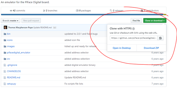

    You can try building/setting it up from the github repository https://github.com/piface/pifacedigital-emulator / https://github.com/piface/pifacedigital-scratch-handler

    Hi Christopher ,
    As you could see , I tried following the README.md from " https://github.com/piface/pifacedigital-emulator "
    Instructions for pifacedigital-emulator :
         An emulator for the PiFace Digital I/O board.
         Install :
         Make sure you are using the lastest version of Raspbian :
         $ sudo apt-get update
         $ sudo apt-get upgrade
         Install pifacedigital-emulator (for Python 3) with the following command :
         $ sudo apt-get install python3-pifacedigital-emulator

    davinha , you have to ignore the readme and merely download the github repo. the github repo has all of the files.
    You'll notice this repository has 'setup.py' which you should probably investigate, similar for the other github link.
    https://github.com/piface/pifacedigital-emulator/issues/9#issuecomment-592191287
    It's unfortunately evident that using 'apt' or 'apt-get' to install the packages is never going to work until yourself or someone else maintains and sets up a new package for Raspbian for the files contained in the github repository.
