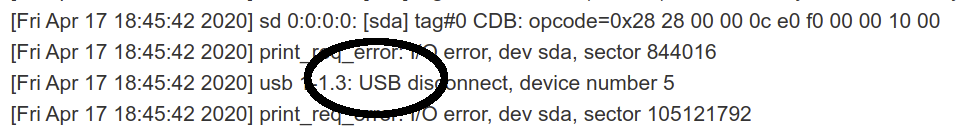

I have an SSD connected to my Raspberry Pi 3B+ using the Element14 Pi Desktop kit.  The drive is recognized as `/dev/sda` in Raspbian Buster and correctly mounted from `/etc/fstab` at boot, but then will disappear after running for a while.
I started to suspect insufficient power (despite Element14's assertion that a 2.5A power supply was sufficient to power the rpi+SSD), so I bought a new power supply that provided up to 3.5A (I have yet to confirm that with my Kill-a-Watt).  I rebooted the pi and and drive mounted correctly as usual, but after about 10 hours, `dmesg` showed:
[Fri Apr 17 18:45:11 2020] usb 1-1.3: reset high-speed USB device number 5 using dwc_otg
[Fri Apr 17 18:45:11 2020] sd 0:0:0:0: [sda] tag#0 UNKNOWN(0x2003) Result: hostbyte=0x03 driverbyte=0x00
[Fri Apr 17 18:45:11 2020] sd 0:0:0:0: [sda] tag#0 CDB: opcode=0x28 28 00 00 0c e0 00 00 00 f0 00
[Fri Apr 17 18:45:11 2020] print_req_error: I/O error, dev sda, sector 843776
[Fri Apr 17 18:45:42 2020] sd 0:0:0:0: [sda] tag#0 UNKNOWN(0x2003) Result: hostbyte=0x03 driverbyte=0x00
[Fri Apr 17 18:45:42 2020] sd 0:0:0:0: [sda] tag#0 CDB: opcode=0x28 28 00 00 0c e0 f0 00 00 10 00
[Fri Apr 17 18:45:42 2020] print_req_error: I/O error, dev sda, sector 844016
[Fri Apr 17 18:45:42 2020] usb 1-1.3: USB disconnect, device number 5

After this, the drive no longer even appears in `lsblk`.  It looks as though something is resetting, but I don't know enough about it to dig in much further.  What is causing the drive to disappear?
Update:
It looks like this might be a kernel bug, but I haven't figured out what to try next.  I'm hesitant to muck with kernel settings that I don't understand.
https://unix.stackexchange.com/questions/239782/connection-problem-with-usb3-external-storage-on-linux-uas-driver-proble…

    Have you try moving the device to another USB port?
    This is just a WAG (wild ass guess) test that is related to something that happened to me with a Pi and a bluetooth keyboard/touchpad https://www.amazon.ca/Rii-RT-MWK01-Handheld-Rechargeable-Wireless/dp/B01FC7J6NC  last summer.The device was stable provided it was plugged into one side of the four ports but not the other.
    This may be a total waste of time and not bring you any closer to discovery. My apologies for this vague description but at the time I was researching SDR and GNU Radio on a Pi and had little time to troubleshoot an errant keyboard. A quick fix that I discovered was if the bluetooth device dongle was plugged into the different pair of USB ports the problem didn't exist.
    I made be way out in left field on this. I don't know how the USB's are arranged on the Pi. Your problem description mirrored something I swore I had seen before. After some thought I recall the small keyboard while sitting on the floor of a living room using the giant screen TV as a monitor.

    0 allenng over 6 years ago in reply to colporteur
    Thanks for the attempt, but you've misunderstood.  This is not a USB port that's having trouble.

    0 colporteur over 6 years ago in reply to allenng
    Hummm there is a USB disconnect error on a sda device in the data you provided. This is followed by block errors on the SSD. How is the SSD interfaced with the Pi. My assumption was it was using a USB port. If not then you are very much with the understanding I was in left field and the ball went into right field.
