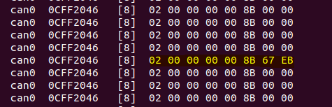

Hi All,
I was wondering if anyone has had any experience using the CAN Controller on the SmartEdge IoT Gateway
The box has a Built-in MCP2515 CAN Controller on board, which is great & why I selected it for a project that requires CAN
For the most part, it works fine, but every so often I'm encountering "Garbage" data coming from the chipset (at a rate of about 1 message every 10 mins with a message cycle of 100ms)
This is shown below, when simply monitoring using candump and nothing else
the shown 67 EB in bytes 7 & 8 are the bits Garbage Data in question. It should be noted that when I do get the garbage, its always the same 2 Bytes and same values.
The sender device is broadcasting the same message repeatedly, so there should be no changes at all!
I was also able to confirm that it is not present on the physical bus by using a PCAN USB and datalogging with Pcan-View at the same time.
The data dump from Pcan-View shows no messages like the one highlighted!
Seems like this is happening on the Controller Hardware or Driver Implementation side on the IIoT Gateway
Anyone encountered this before? Either on this product or any other Raspberry Pi ?

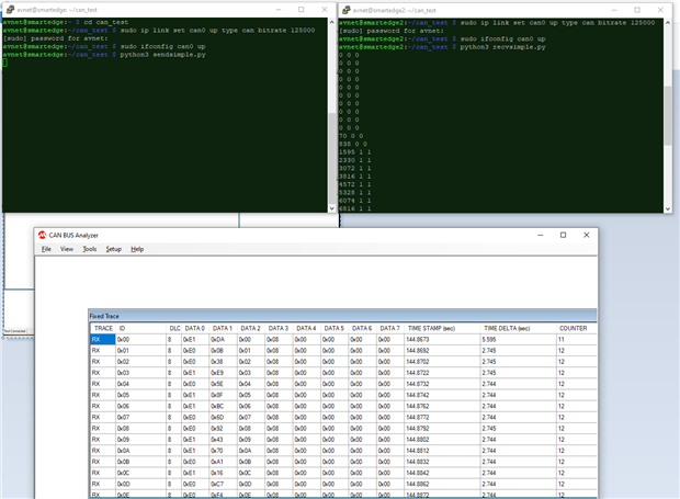

    0 roryyorke over 5 years ago in reply to Jan Cumps
    I've put the code at https://github.com/roryatario/smartedge-can-tester
    The scripts need the python3-can package ("apt install ...").
    Run "python3 sendsimple.py" on one SmartEdge, and "python3 recvsimple.py" on the other; recvsimple will print number of total, bad, and bad-matching-pattern packets once a second.
    You might need to increase the transmit queue on the sender (`ip link set can0 txqueuelen 50`).
    FWIW, I've just confirmed that I see this bug in a candump recording from packets sent from a completely different device, so the error occurs on the receiving side.

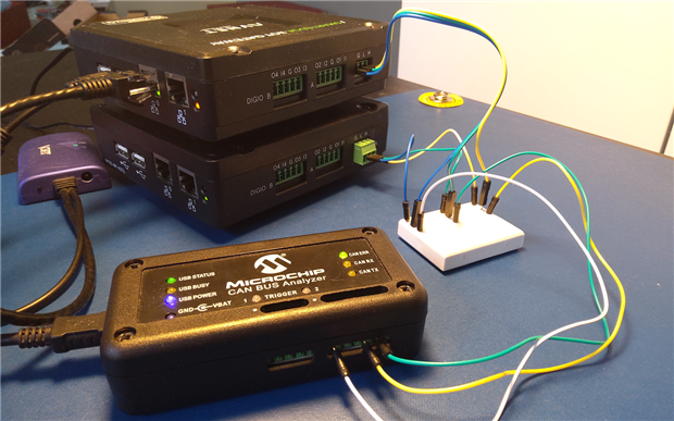

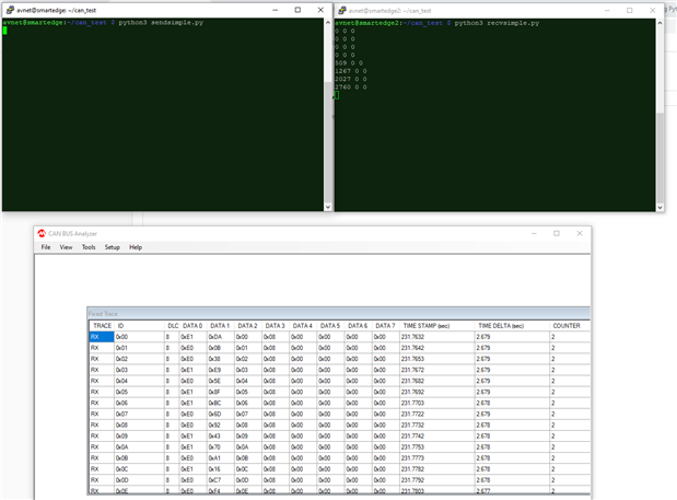

    0 Jan Cumps over 5 years ago in reply to roryyorke
    I've done the hardware setup.
    The MicroChip analyzer only snoops traffic. It doesn't interfere.
    I'll now install the Python libs and check the test scripts.
