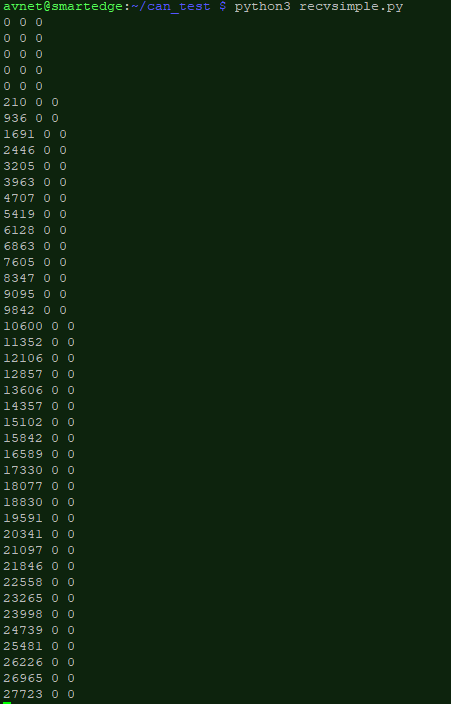

    0 Jan Cumps over 4 years ago in reply to Jan Cumps
    roryyorke ,  the tests look good.
    Here are the first set of results:
    I let the test run continuously for approx. 10 minutes, ID 200000, and it didn't report a mismatch.
    edit:after 600000 tests, still good:
