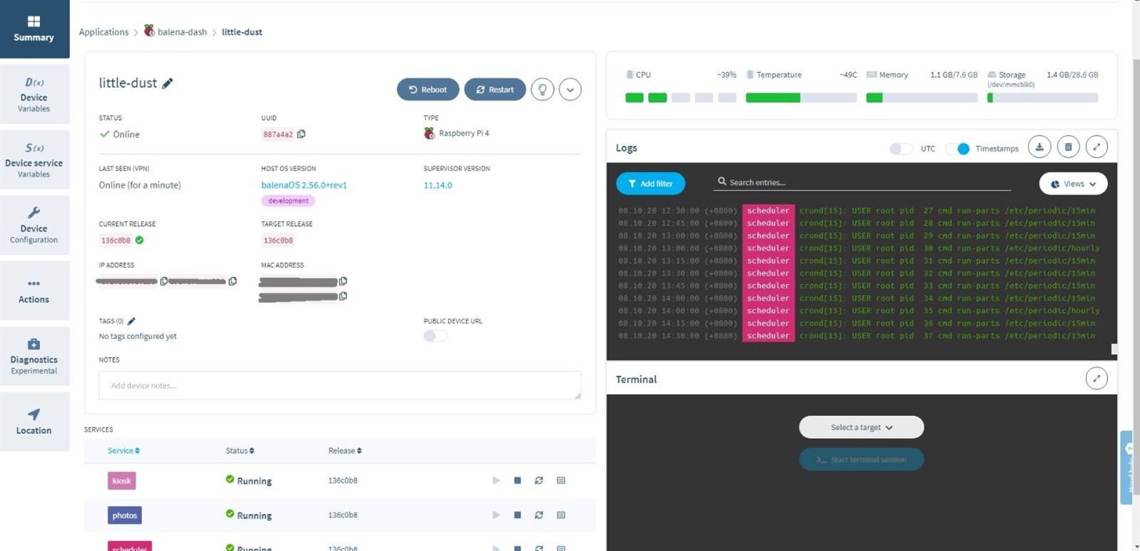

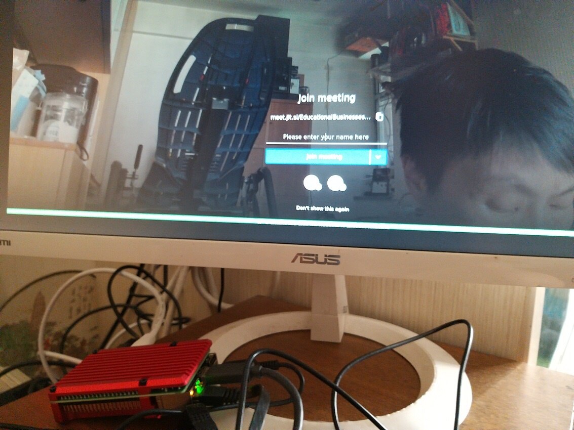

I've been working on this project, and am loving it! Hope more people can join this exploration and help me out by answering 2 questions:
1. How to ask the browser to automate the "join meeting" button? I know there are python browser automation libraries but I don't know how to implement them.
2. How to configure the device so that the Jitsi Meeting room can be remotely launched with cellular/GSM connections? It can now be connected with either ethernet or wifi.
The video call function is working ok, but the user on the other end has to click the "join meeting" button. And if the connection is off for some reason (usually with wifi), I need to relaunch the app from Balena's dashboard or the user on the other end has to click the "join meeting" button AGAIN. It isn't ideal for isolated people who may never have the experience of using a mouse.
Hope to hear from you!

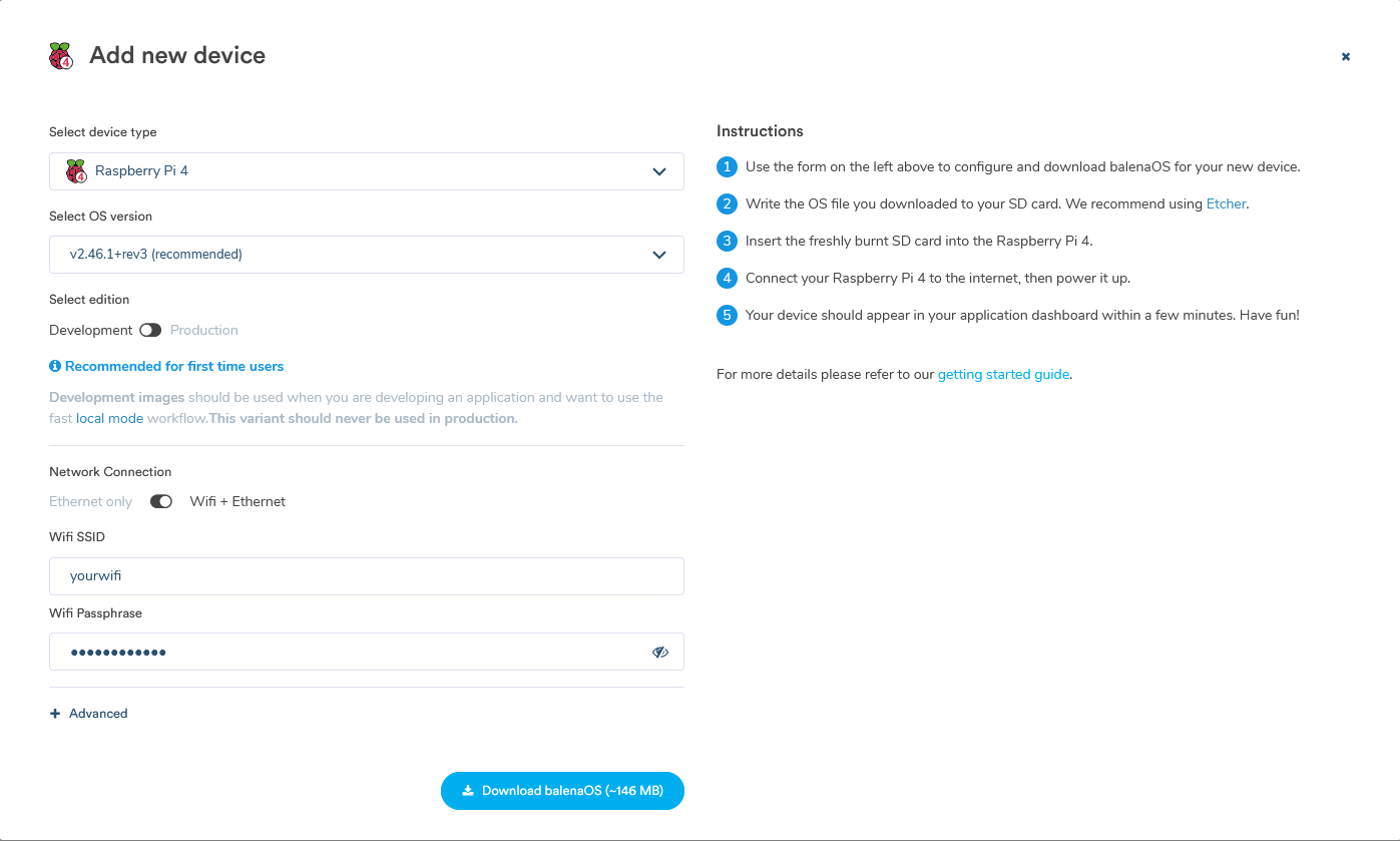

    And one more question:
    on the project page, it says the wifi settings (SSID and password) can be changed when the device is moved to another location. But it doesn't mention how to change them. Would be grateful if someone can help!

    The Balena Cloud setup allows me to input wifi settings from the Dashboard, then the disk image is downloaded and flashed onto an SD card. It works perfectly, but I don't know where and how to change the wifi settings if I move it to another home.

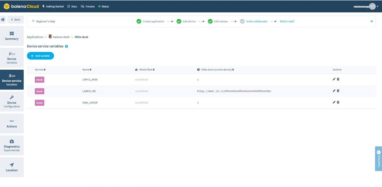

    The Balena dashboard allows me to add and change the Device Service Variables through some input fields. There is also a terminal where I can have remote access to the RPi as a root user, but I have no real work experience with CLI.
    If you can give me some step-by-step guidance, I should be able to follow, hopefully, ^^
    I can change the LAUNCH_URL variable by typing in any web address. Since Jitsi does not require any sign-up or registration, it automatically pops up the meeting page.

  • stevie2018
    0 stevie2018 over 5 years ago in reply to mfetting
    You are totally right!
    In jitsi, rather ambigously hiding in the setting menu, there is a box that I need to uncheck - "Enable pre-meeting screen".
    Thank you Mike!
