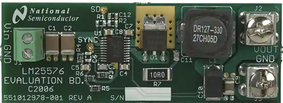

    Good point, I use LM25576 evaluation board to power a Pi from 12 V lead acid battery (and continuously charge the battery by an external charger).
    The only thing I modified are the two voltage divider resistors, so I set the output voltage to 5.15 V (as most of the Pi supplies use 5.1 V or similar to cover the wiring loses).
