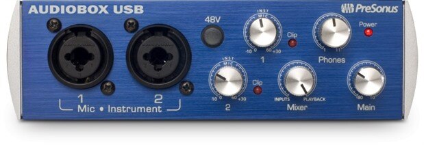

    I have one of these. Note how far the Phones volume control goes image Yup, I'm a geek too...
